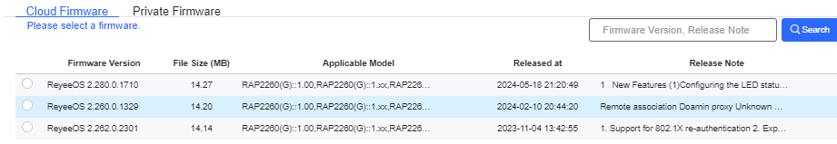

  • Check whether AP works in the latest firmware version
    Please upgrade the Reyee AP to the latest version (AP 3.0(1)B11P86) before you configure the mesh function.

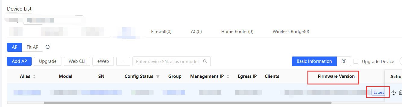

  • this is the latest version on my cloud, AP model is RAP-2260 (G).
