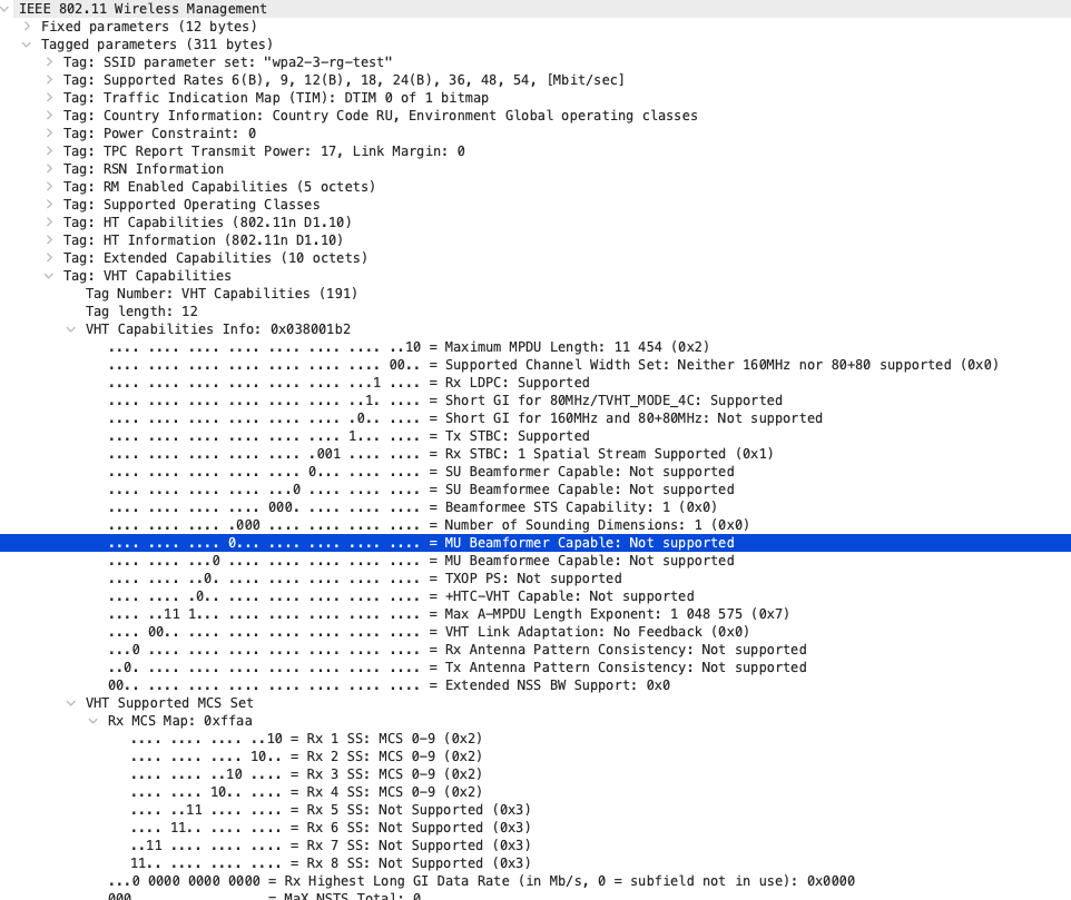

Dear Wireless Experts!
I have problems with enabling MU-MIMO on AP840-I(V2) and AP880-AR access points (in fit mode under control from RG-WS6512): parameter "MU Beamformer Capable" in BEACON always shows as "not supported" from both APs regardless of "mu-mimo" configuration under ap-config section:
Could you, please, help me with enabling this feature.
Controller configuration is posted below.
Alexey

Thank you Sophia.
Didn't get anything yet... Why you won't to post an answer here?
Regards,
Alexey
