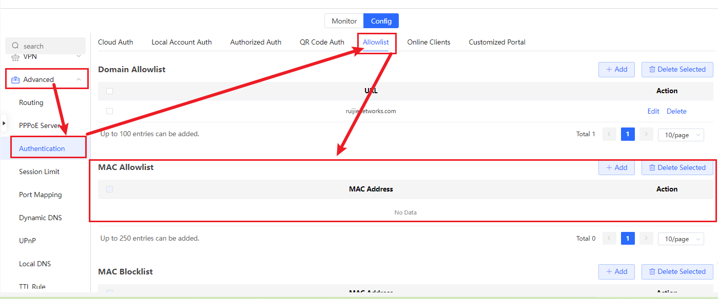

Hello,
As mentioned by Kevin Bryan Laurea, you need to first confirm the device you are using. If it is a reyee EG, you can whitelist the mac of the TV in the allowlist:
If you still have any issues please talk to me again, I would be glad to help you in community.

Hi Thanks for the reply.
I have non rujie AP's.
Just asking is there any button or settings im not seeing that I can just click to bypass captive portal authentication.
Found the work around of using the allowlist at setting the device mac or IP there but im still looking if there is a button or setting to just change.
Thanks.
