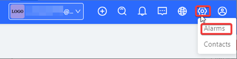

Clickat the upper right corner, and click Alarm. When no alarm is configured, global settings are used. On the Alarm Settings page, you can specify whether to enable or disable alarms and how the alarms should be received.
Procedure
(1) Click at the upper right corner and click Alarm Settings.

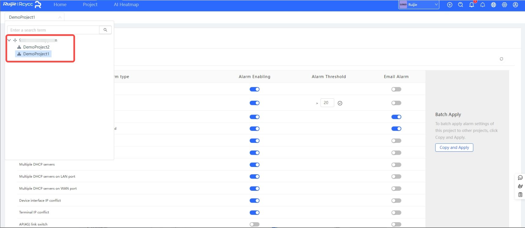

(2) Select one project in this account.

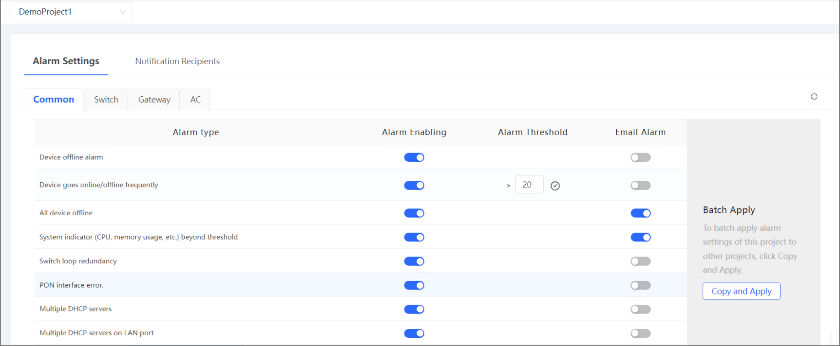

(3) Set alarm parameters.
Alarm Type: indicates the type of alarms.
Alarm Enabling: indicates whether to enable the function. If the function is enabled, alarm information is displayed on the alarm page.
Alarm Threshold: indicates the alarm threshold.

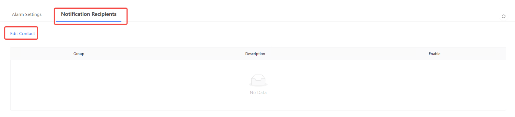

Email Alarm: indicates that alarms will be pushed to the contacts in Notification Recipients of the network through the email when Email Alarm and Status are enabled.
