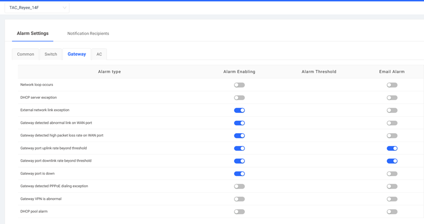

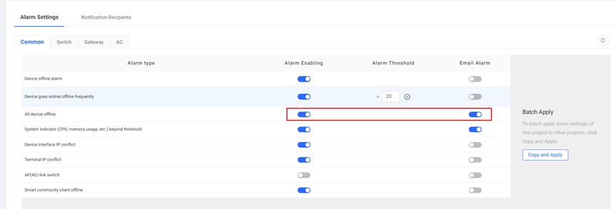

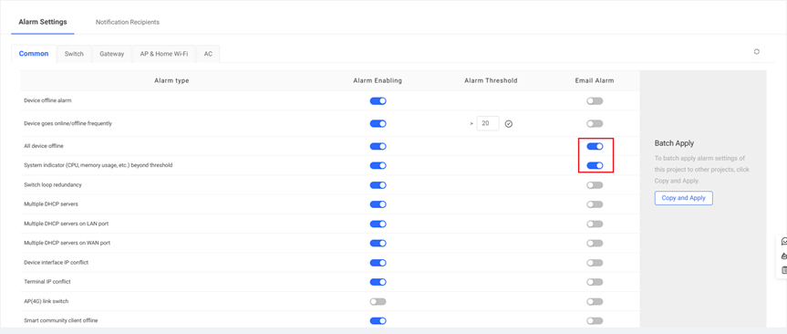

1. Alarm configurations are incorrect
Please follow this guide to configure the alarm: community.ruijienetworks.com/forum.php?mod=viewthread&tid=8304&page=1&extra=#pid16951

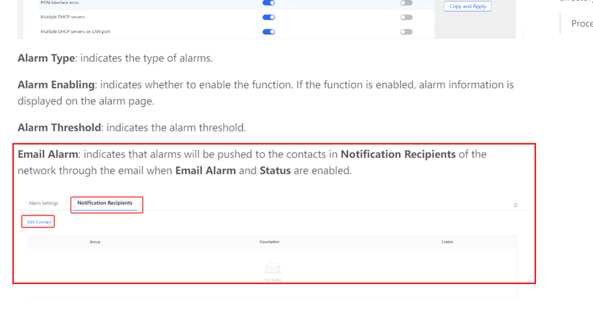

Check whether the corresponding Alarm item is set to “Enable” and whether “Email Alarm” is selected. The email alarm is triggered only when both functions are enabled.

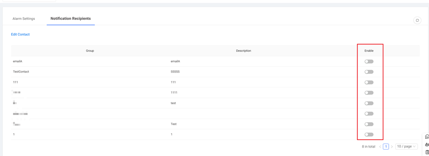

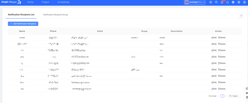

2. The notification recipient is incorrect
After an email alarm is triggered, the cloud mailbox will send emails to the specified email. Therefore, if the specified email is incorrect or unreachable, or you add the cloud mailbox to the blacklist, you may not receive alarm emails as well.
After adding notification recipients, you need to select email recipients on the alarm screen. If you enable email alarms but do not select email recipients, you cannot receive email alarms as well.
