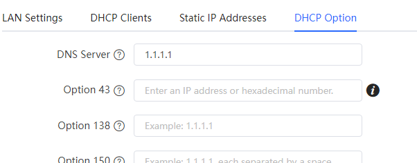

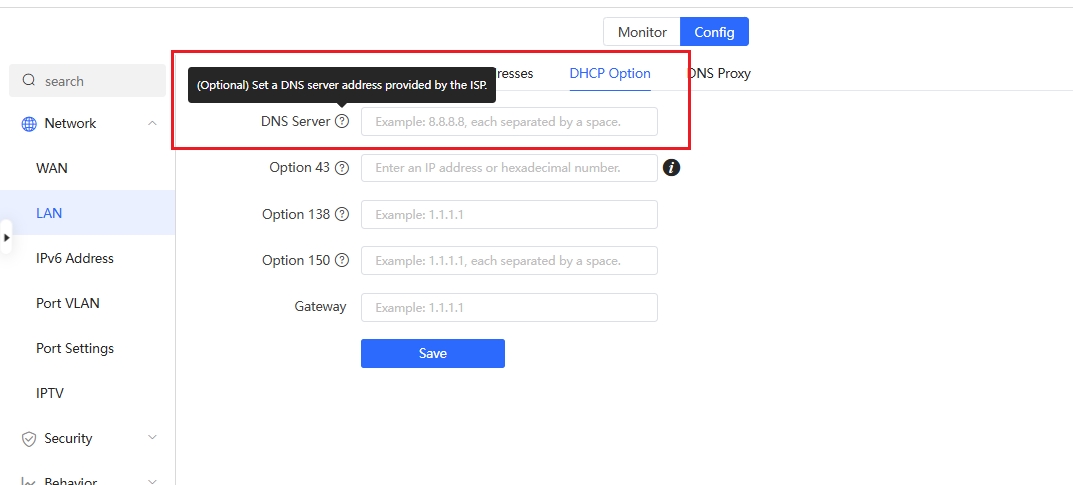

Hello Andrei Achrat,
Please check this pocture for configuration
If the issue still exists, please help to  share the screenshot of your current setting and you can talk with me again. I be glad to help you in Community.
0 2024-6-5 13:39:34 View all replies
GTAC-Micca replied at 2024-6-5 13:20
still same

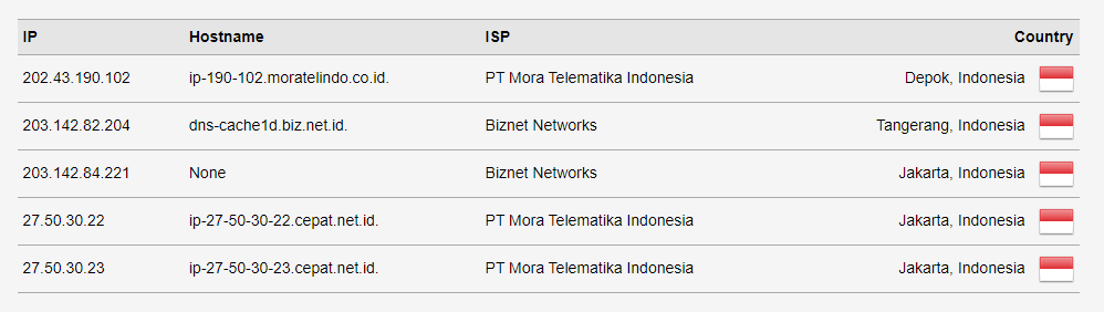

I'm sorry that we can't provide a specific solution for you based on current information.
Please help to confirm your current problem. Is the DHCP address obtained by the user and the user DNS is from ISP instead of the DNS set on the device?
If yes, please help confirm the following questions:
1. Check whether the user gateway is on the EG
2. Where did you check this DNS? Can you take a screenshot for me?
3. Is there any way to help capture the packet and share it with us for troubleshooting?
0 2024-6-5 14:10:39 View all replies
GTAC-Micca replied at 2024-6-5 13:48
I'm sorry that we can't provide a specific solution for you based on current ...
> User gets ip from EG dhcp but not dns, dns always override by isp'dns
> Yes on EG
> How to do it?

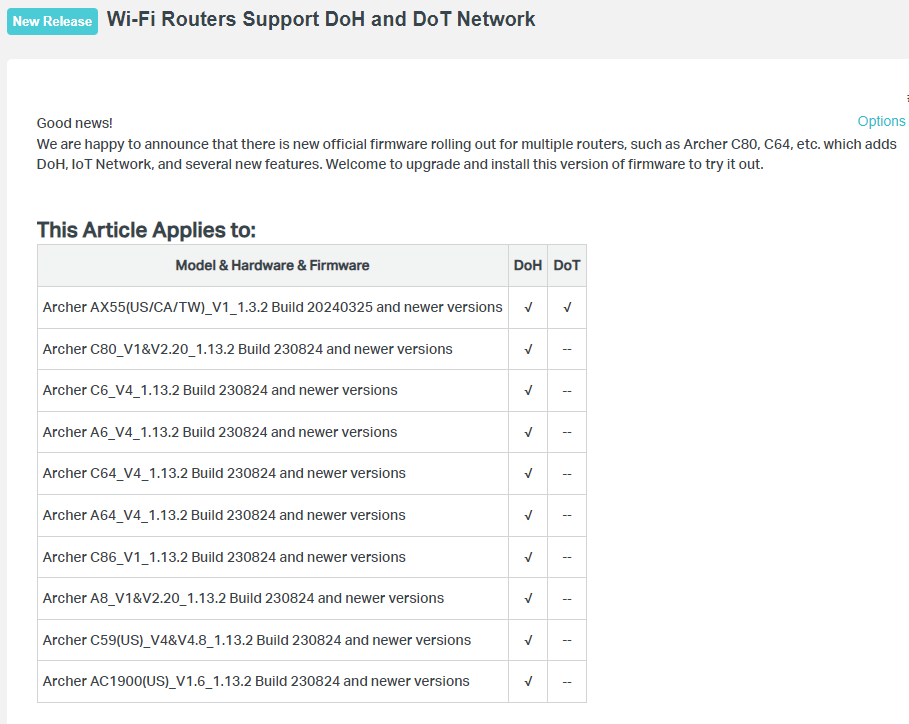

Is there a plan for EG to be able to use DNS over https? because I previously used another brand and was able to bypass the ISP's DNS using DNS over https.

He want to set the device with DNS-over-HTTPS (DoH) or better DNS-over-TLS (DoT) protocol, but I think Ruijie doesn't support, is there plan to support this in the future?
Other brand already support DoH and DoT

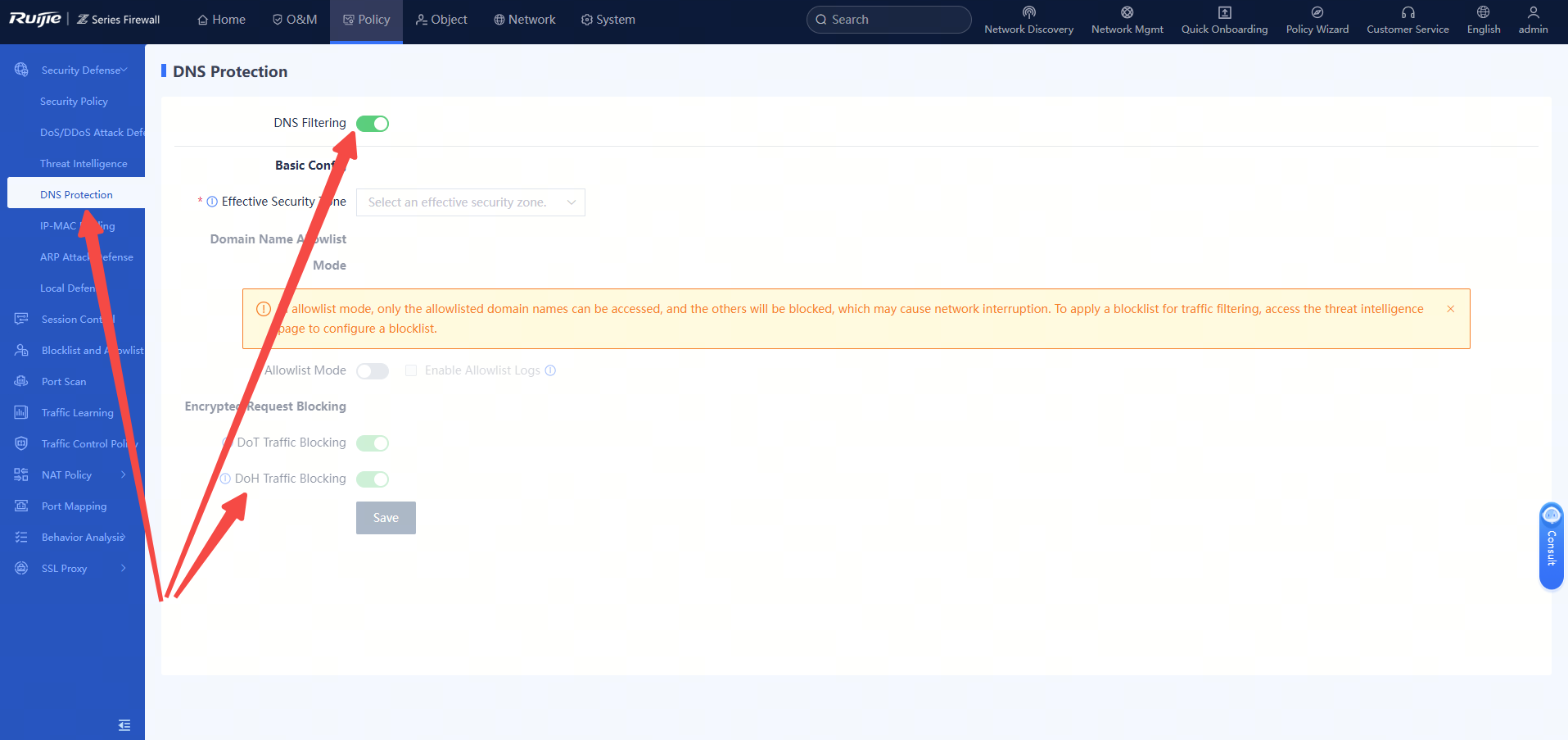

can it be done using raspberry pi for DOH and DOT ?
0 2025-7-28 16:26:36 View all replies

Sir,
you can configure the DOT and DOH in there now.
