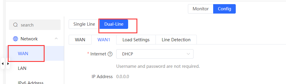

Can anyone help to guide a step by step to enable dual wan for EG105G-P-V2?
Any help will be greatly appreciated thanks.
RG-EG105G-P V2
Network Setting Router
0 2024-6-9 13:02:23 View all replies
You can enable this function on the device

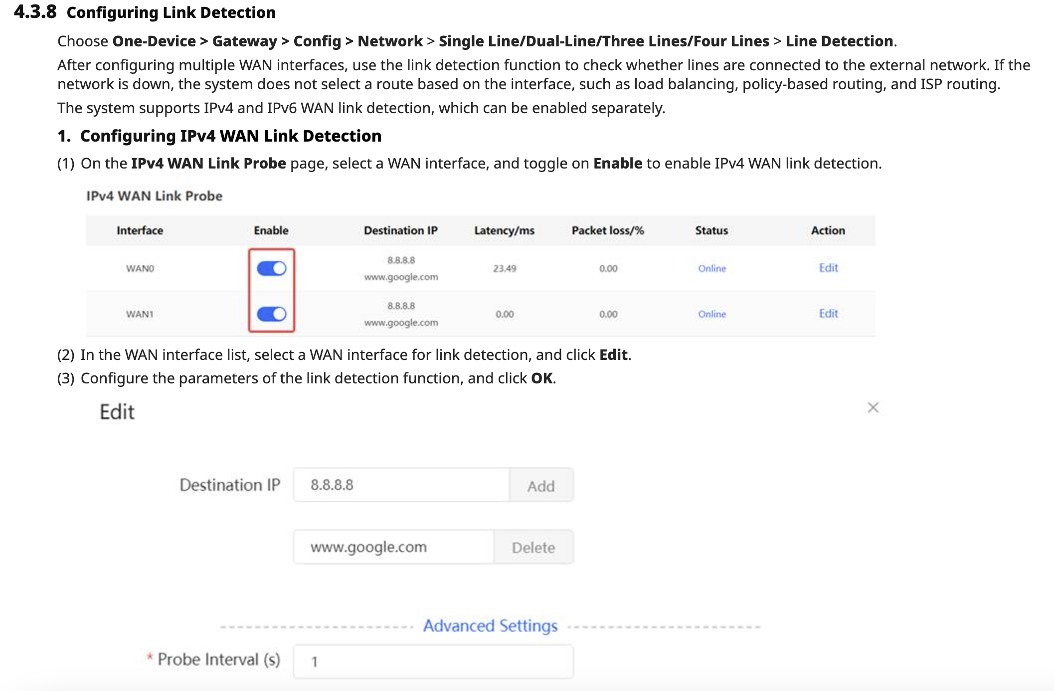

Hi, I have load balancing configured for 2 WANs, but I don't see where the failover is. For example, if an interface goes down, how can I check that it went down to only take you out through the one that is active?RegardsPS: I don't see the Line Detection Option

Dear sir,
Good day.
May I know your device model?
Please help to check the firmware version of your device is the latest one or not. If not, please upgrade the firmware first.
