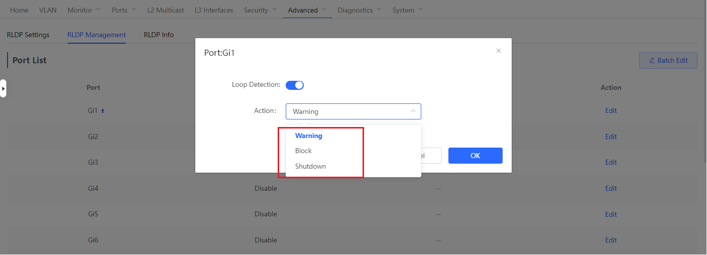

You can change the action type of the port. But I suggest you check again to see if there is a loop in the network. You can unplug the device from the down port and test it again.
There are three methods for handling port faults:
Warning: Only related information is displayed indicating the current fault port and fault type.
Alarm and Blocking Packet forwarding (Block) : After a fault alarm is generated, the faulty port is configured not to forward the received packets
Alarm and Shutdown port: After a fault alarm is generated, the port is shut down
