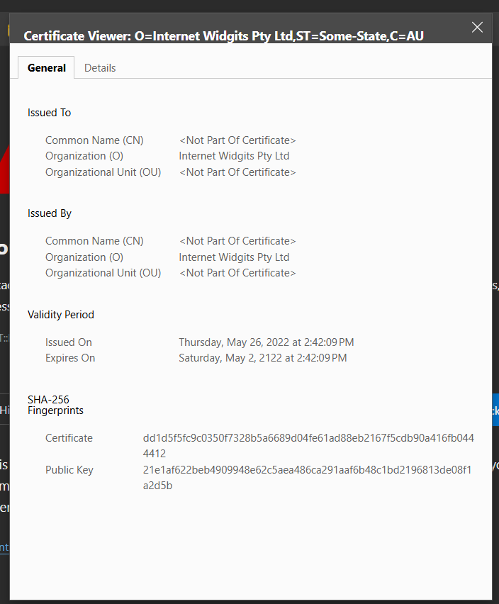

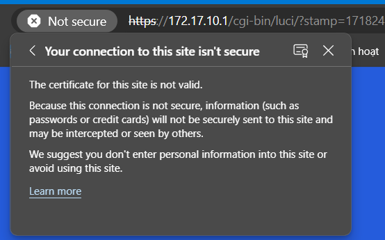

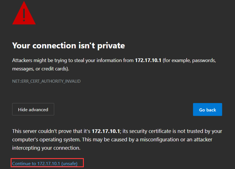

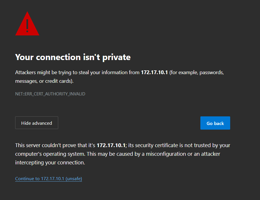

After upgraded my EG305GH-P-E
to new fw ReyeeOS 2.280.0.1620 both Edge and Firefox warning about invalid certificate, how to resolve this issue?
NET::ERR_CERT_AUTHORITY_INVALID
Subject: Internet Widgits Pty Ltd
Issuer: Internet Widgits Pty Ltd
Expires on: May 2, 2122
Current date: Jun 11, 2024
RG-EG305GH-P-E
Firmware Router

Hi Manh Cuong Nguyen,
The upgrade may change the root certificate or certificate chain of the AP. As a result, the trusted SSL certificate is no longer recognized by the system.
It is advised to ignore it because it does not affect the actual use of the device

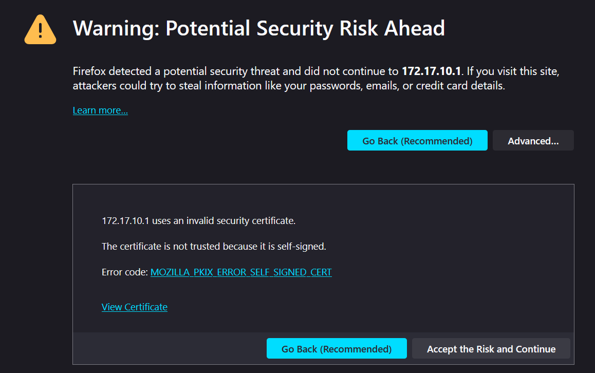

Hi,
Thank you for reaching out regarding the certificate warning issue after upgrading your EG305GH-P-E to the new ReyeeOS 2.280.0.1620 firmware.
The HTTPS certificate used by the EG device can only be verified on the EG itself, which is why your browser prompts a warning about an invalid certificate.
To resolve this issue, you can do one of the following:
  • Add an exception for the certificate in your browser:
    • For Edge: When you see the warning page, click on "Advanced" and then "Proceed to [IP address] (unsafe)".
    • For Firefox: Click on "Advanced" and then "Accept the Risk and Continue".
    </li>
  • If you prefer to avoid the warning, you can import the certificate into your browser as a trusted certificate. This can be done through your browser's certificate management settings.
Please let us know if you need further assistance or detailed steps on how to import the certificate.

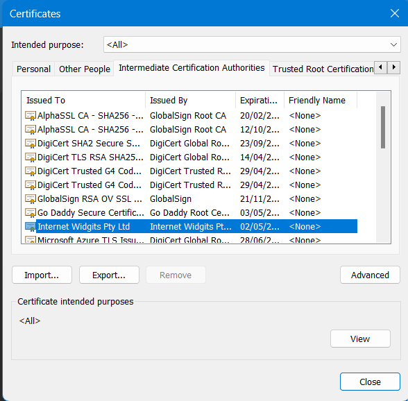

Thank for the information, I already added EG device certificate into Edge but still get the warning.
BTW, why this didn't happen with previous firmware version?
