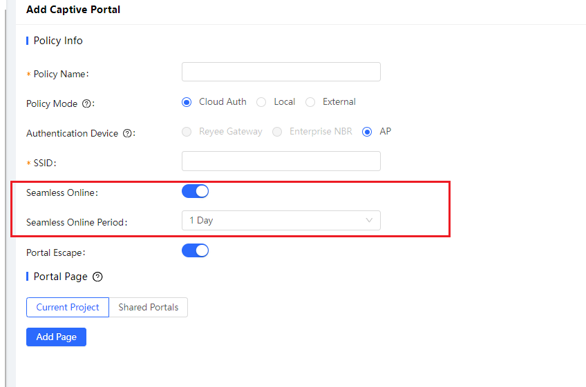

Hello,
I‘m sorry that we can't provide a specific solution for you based on current information. Can you help to check the following aspects:
1. Do you have seamless online enabled or configured? May you take the screenshot of your setting for checking?
If yes, how long did you set it for?
If it is disable, you can enable and set the time to test again.
"Seamless Online" refers to the process where a user uses a device to access the internet and only needs to perform web authentication for the first login and there is no need to authenticate again when using the same network from the 2nd time. After the user goes offline, they can also reconnect within the specified time without the need for authentication.
Here's the Seamless Online function instruction, you may refer to these post: https://community.ruijienetworks.com/forum.php?mod=viewthread&tid=4552&extra=page%3D1
If the issue still exists, please talk with me again. I would be glad to help you in Community.

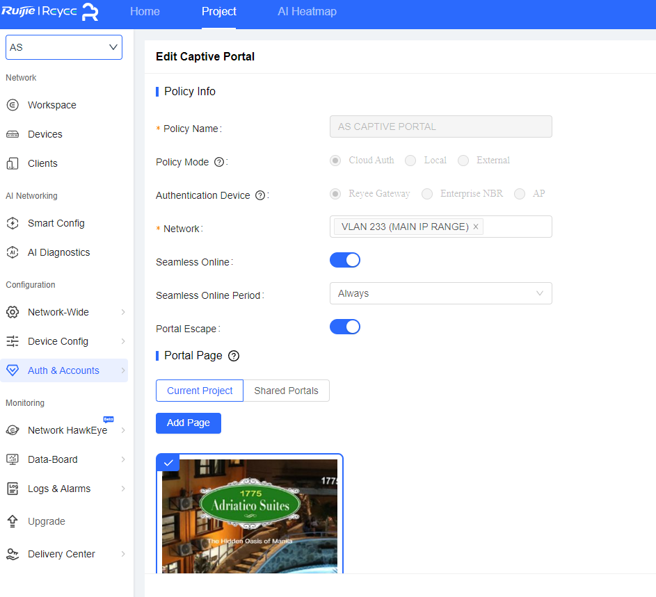

Hi Micca
I have this turned on and is set to "always" but still being ask to enter voucher again after transferring to a different SSID from another access point.
Please note that for now i only 1 rujie home router set as AP mode and 2 other brands AP.
when hopping to the other brands AP Im being asked to log in again using voucher and user account.
I understand that I can resolved this issue by using the allowlist thanks again for the answer you provided.
But i dont want to do that everytime i have guests that wants to connect to my internet.
Also i dont have the budget yet to buy rujie AP's and just want to make use of my existing non rujie brand AP's for the moment.
Any help is greatly appreciated

Hello,
Can I reconfirm some details with you
1. Are users connected to different devices with the same SSID?
2. Please help to check whether the SSID on each AP is the same vlan.
3. Could you please show me the configuration of the authentication range on EG and the authentication IP of the test user
4. Can you shoot a video to show me the auth process?
