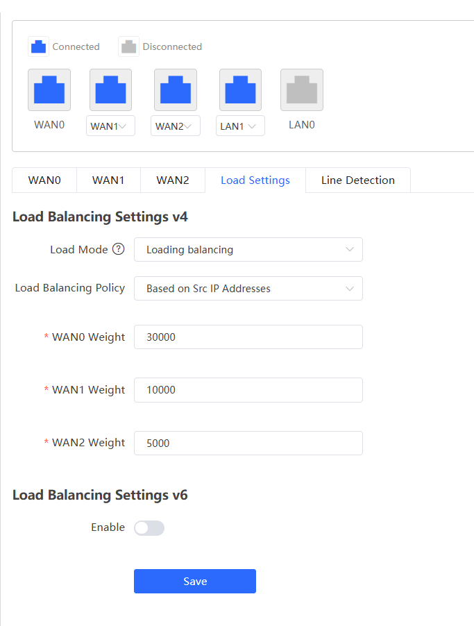

i use Based on Src and have WAN 3 Line
WAN0 = Down 1000 / Up 500
WAN1 = Down 300 / Up 300
WAN2 = Down 700 / Up 500
i config weight here

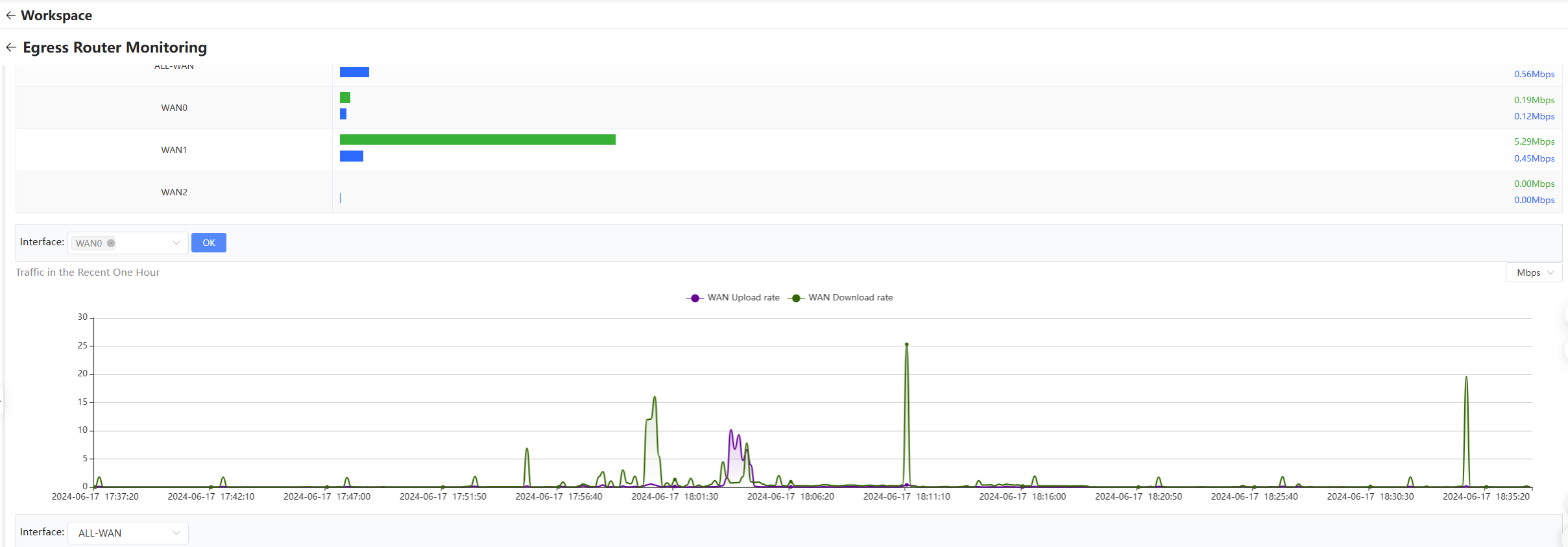

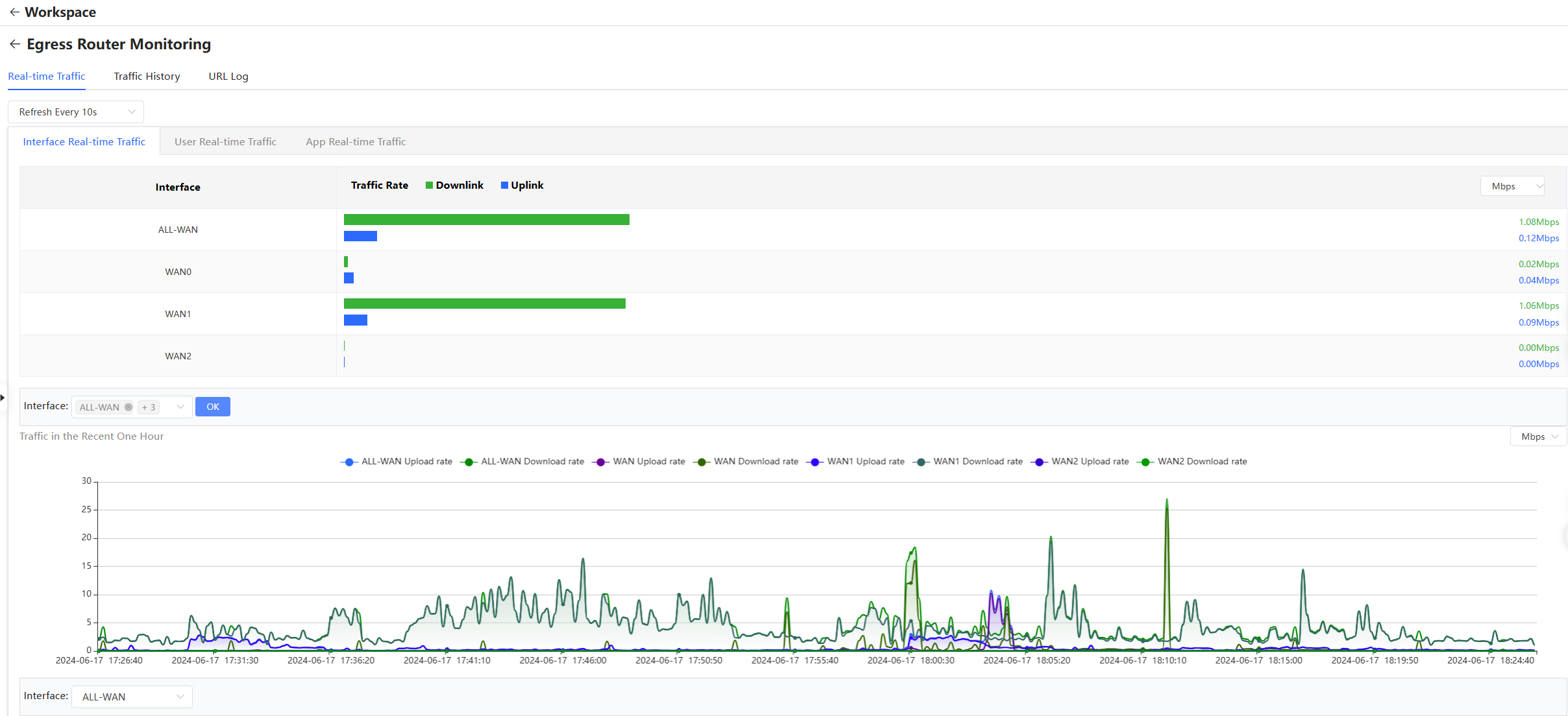

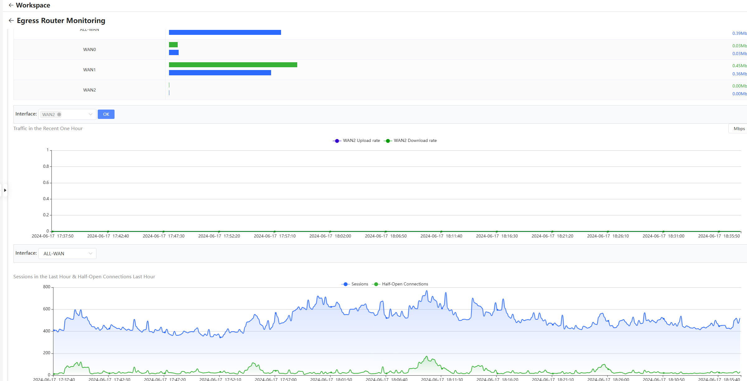

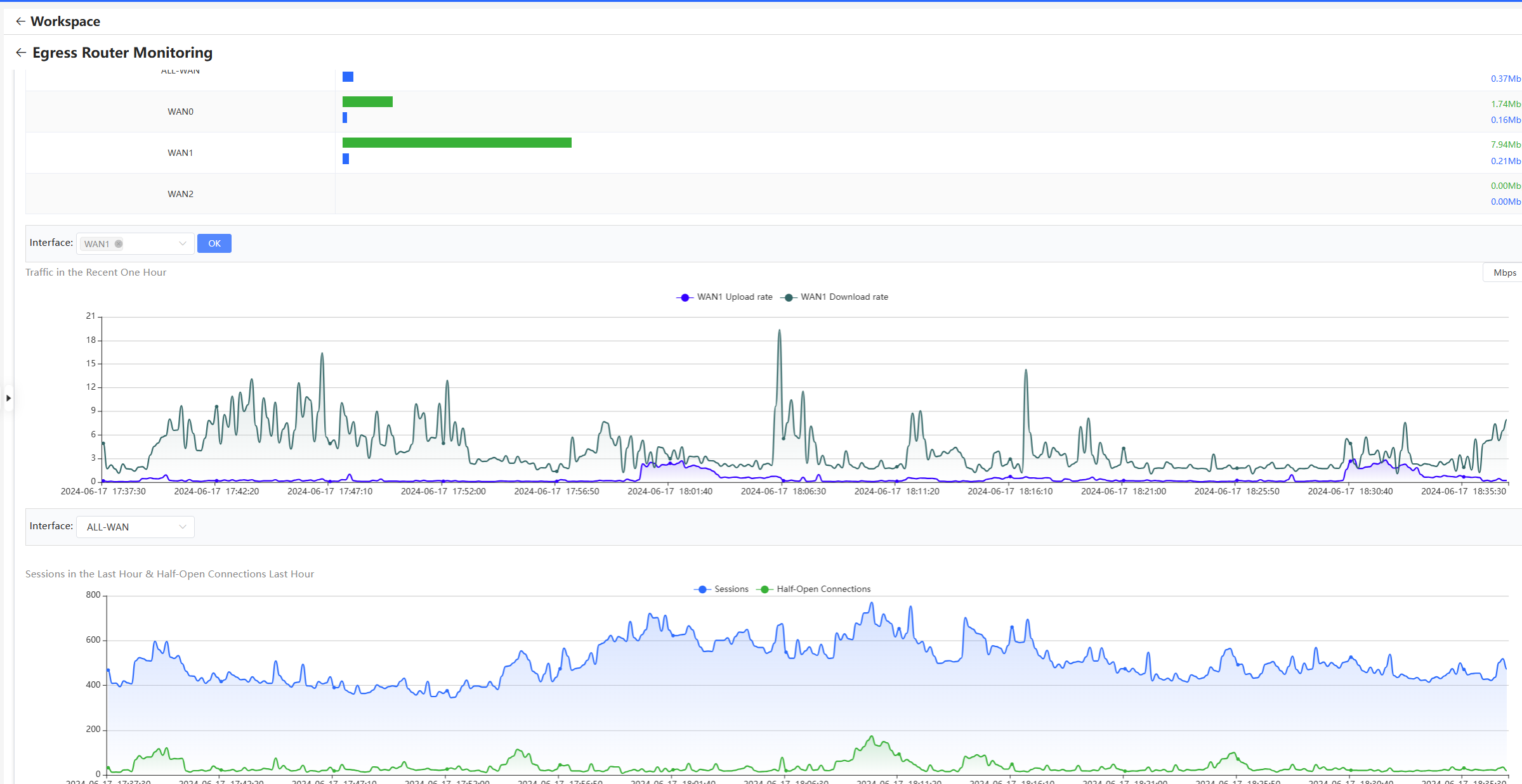

but WAN0 not use or not have Download / Upload on WAN0
Router use WAN2 and WAN1 greater than the set weight value

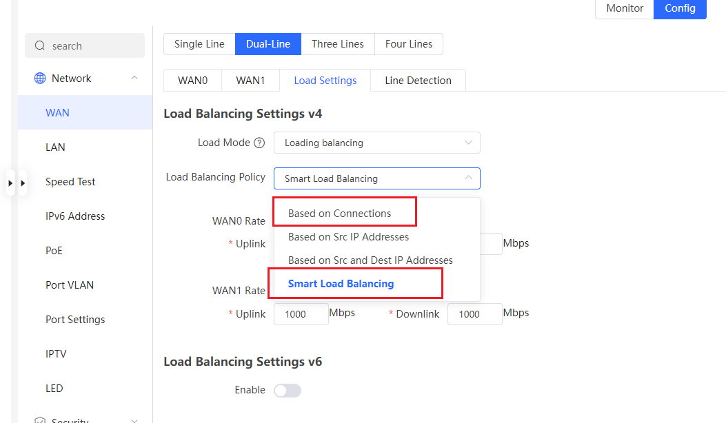

the src IP address-based policy means that if your IP is selected to go out from the current wan port, then traffic will go out from that wan port.
May you try test based on connections or smart load balancing for a test?
