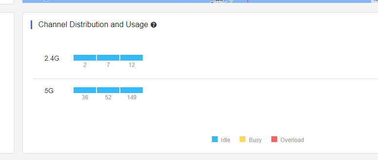

Dear all
Why is Reyee AP using the 2-7-12 channel, not the reasonable 1-6-11 ?

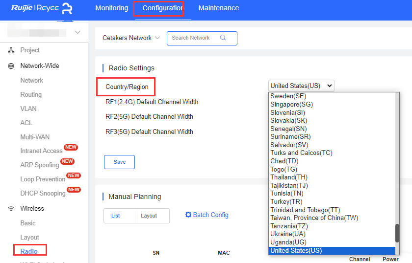

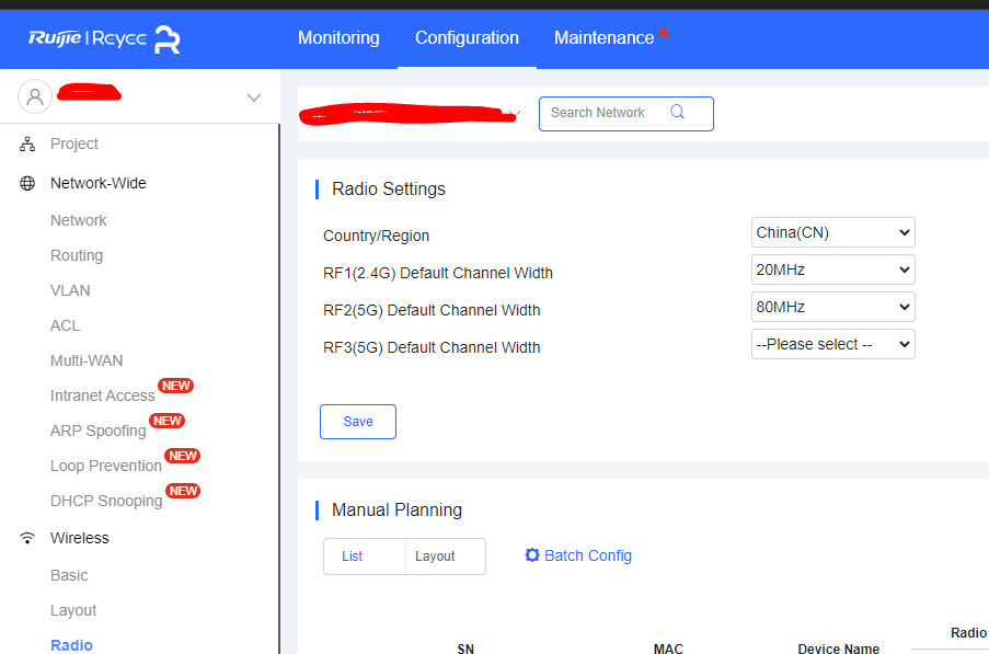

1.Check the current country code by following steps,Because different countries support different channels
The channel in some countries is a radar channel, so when the country code of some countries is selected, only the channel supported by the corresponding country can be displayed
2.You can also try to change the Country code on the Radio setting to check whether there will be other options for channle
If the issue still exists,  talk with me again. I would be glad to help you in Community.

Can you show me the Channel list for each Country code over Ruijie Cloud?
0 2024-6-20 14:41:40 View all replies
Cheong Ming Wong replied at 2024-6-20 14:14
Sorry for the Channel list for each Country code on the Ruijie Cloud
We didn't have relate document of it
For the support Channel on different Country code, you can only view it when switch to different Country code
