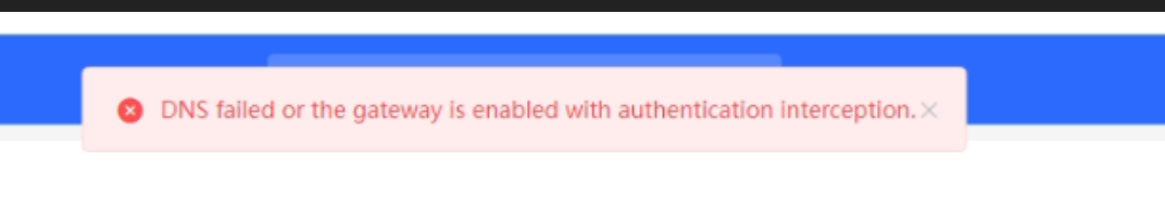

DNS failed or the gateway is enabled with authentication interception
7301 1 2024-6-27 18:36:47
how to solve

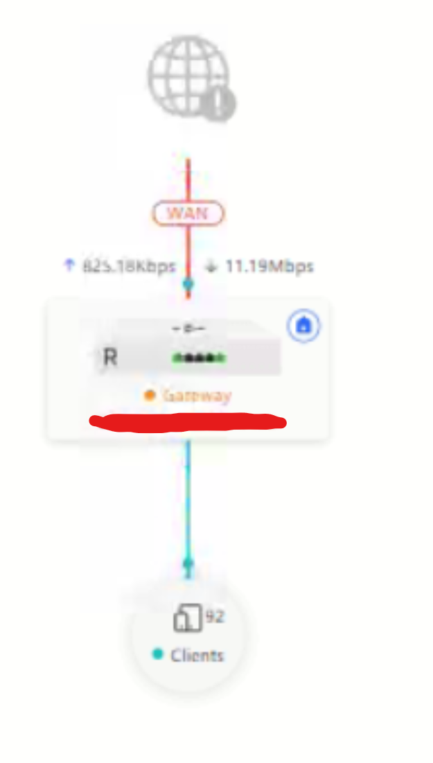

Experiencing intermittent disconnection with this prompt
Already added Gateway IP and Mac address, Isp modem IP and public IP to allowlist.
Still issue persist

Hi sir,
Please refer to these step to do a troubleshoot first.
1. check all the isp dhcp configuration, it is better config DNS to 8.8.8.8(This need config on isp).
2.configure local dns as 8.8.8.8 on EG
3.configure line detection on EG
Steve
