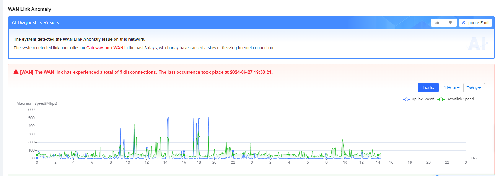

Experiencing intermittent disconnection with this prompt
Already added Gateway IP and Mac address, Isp modem IP and public IP to allowlist.
The Issue still persist
Thanks!

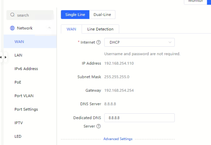

  • May I know the current WAN port setting on the device, if device can still work properly on the local network

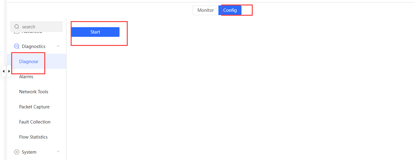

  • Check the Diagnose result of the device here

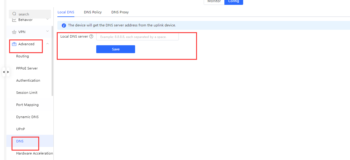

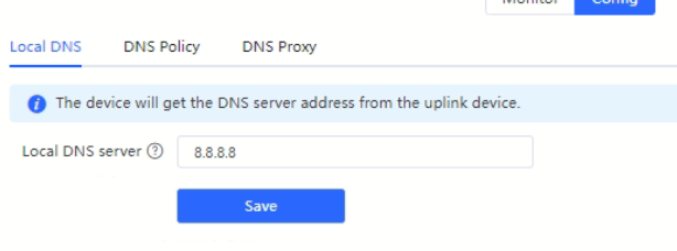

  • May I know if you can try to configure static DNS server to 8.8.8.8on the device and check whether the same error still promet?

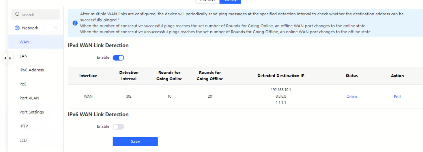

Im pinging 8.8.8.8 -t  continously when this appear appear my ping is still alive
But browsing lags so bad.
