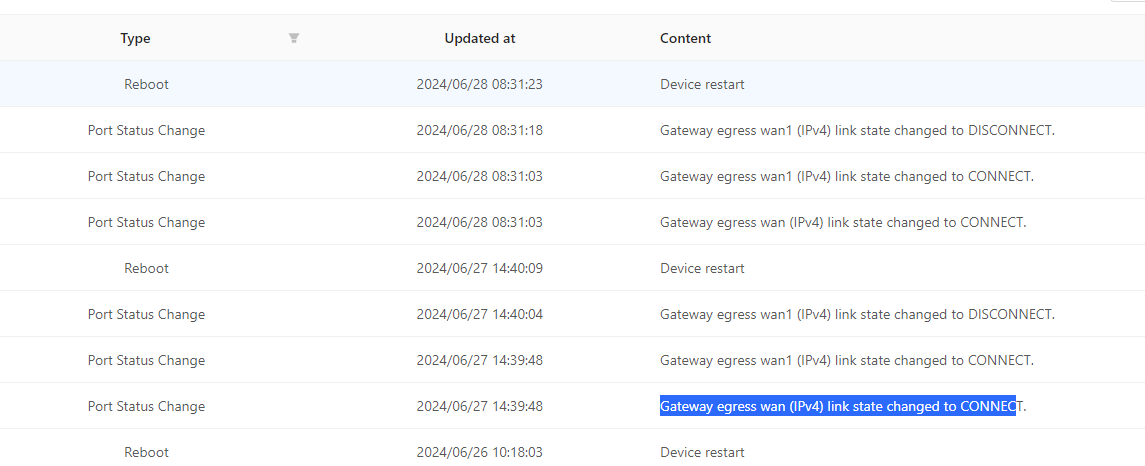

Why the EG1510XS reboot I see on the logs.

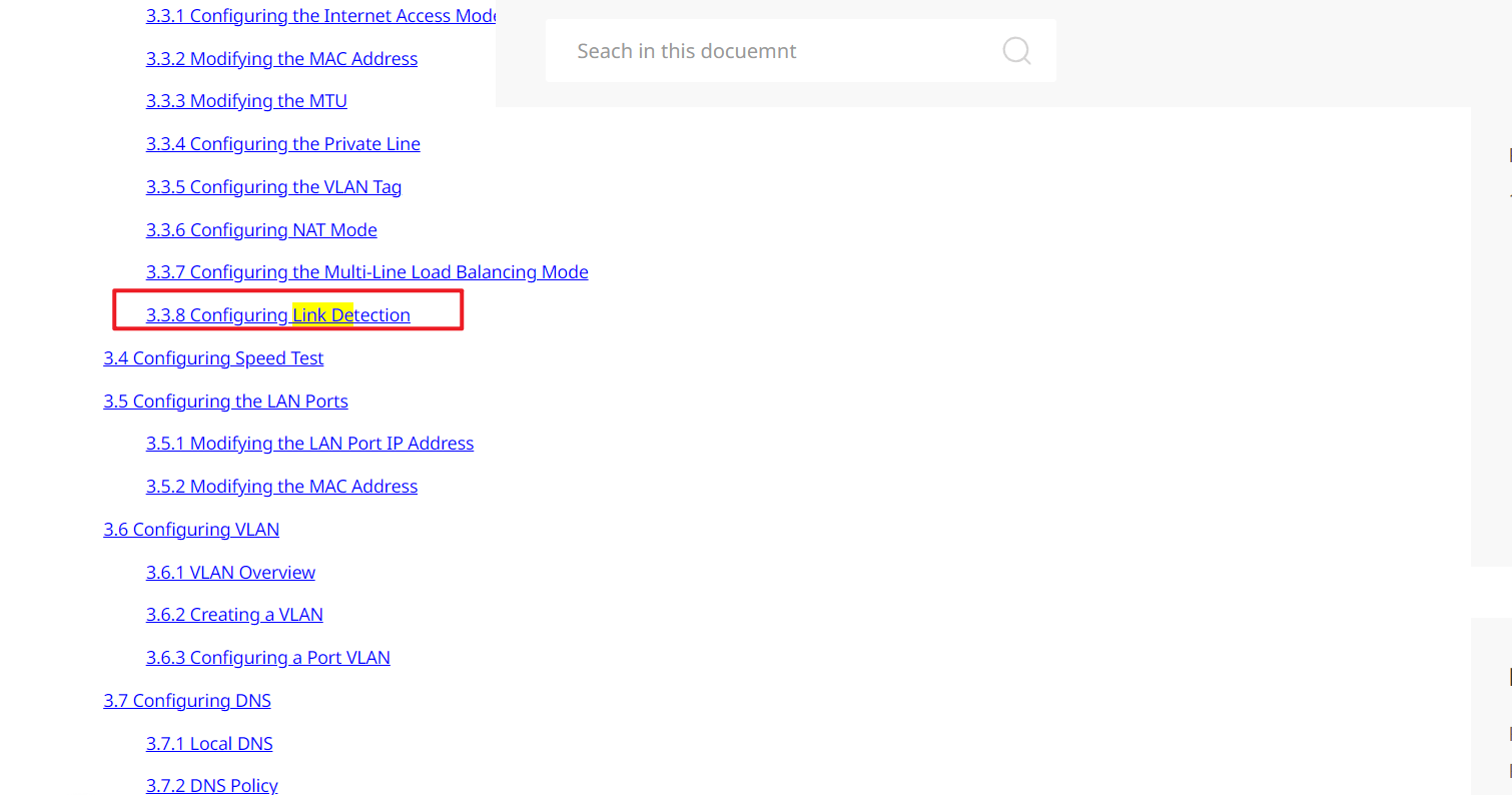

This may be caused by unstable links. It is recommend you try replacing the network cable for a test.
Also, you can configure link detection:https://reyee.ruijie.com/en-global/support/documents/slide_rg-eg-series-routers-configuration-guide?page=html&keyworks=LINK%20DE
