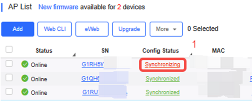

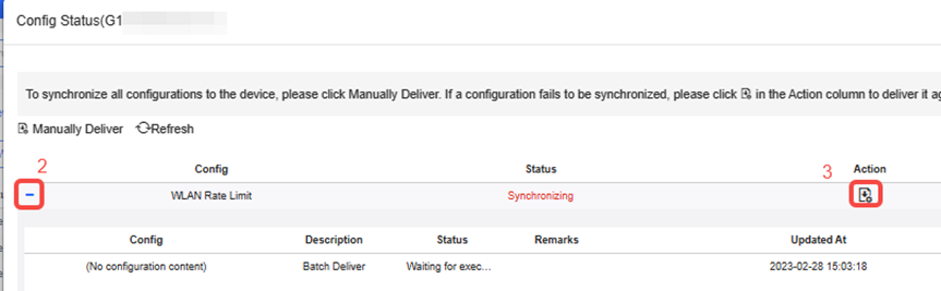

2. Review the options that cannot be synchronized and try to synchronize manually
If it still cannot be synchronized after waiting for 10 minutes, you can manually synchronize the configuration that cannot be synchronized separately.

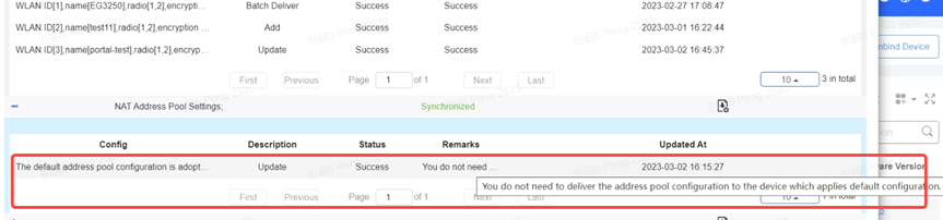

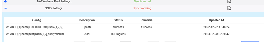

3. View syncedcontent, sync status, and remarks.
After manual synchronization fails, check the execution result. Through the following interface, you can see the execution content and result.

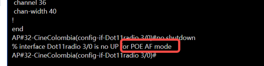

4. Go to the command line interface to confirm whether the command to be synchronized has been executed.
According to the executed content, go to the CLI interface to check whether the device configuration has actually been completed. It is possible that the execution has been successful. The cloud has not received the execution result due to network or device reasons, and it still shows that the synchronization is not successful. If the device configuration is not successful, you can try CLI manual configuration to see if it can be successfully executed. Because there may be problems on the device side, the command cannot be executed.

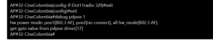

Inthe following case, the configuration of radio 2 and radio 3 was sent to the cloud, but due to the POE AF mode power supply on the device side, radio2 and radio3 could not be enabled, resulting in synchronization failure

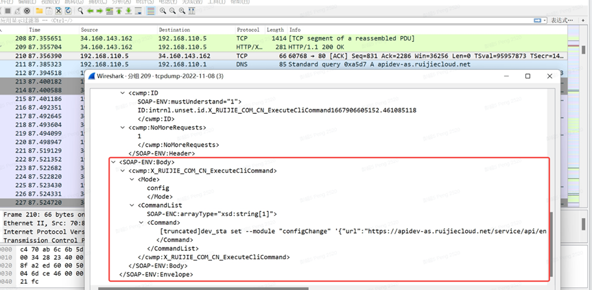

6. Packet capture boundary
Implement packet capture on uplink devices and trigger configuration synchronization during the packet capture process. Analyze whether the configured message has been received. If no such message has been captured, it is recommended to confirm whether there are security policy restrictions on the network exit. There levant ports to the cloud that need to be released from the device are: TCP80, 443, 25857, UDP 3478, 3479.
