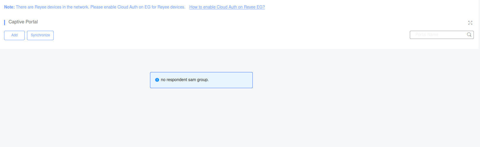

Hi, on my ruijie cloud, I choose captive portal and there is a pop up: no respondent sam group.
For the information I have:

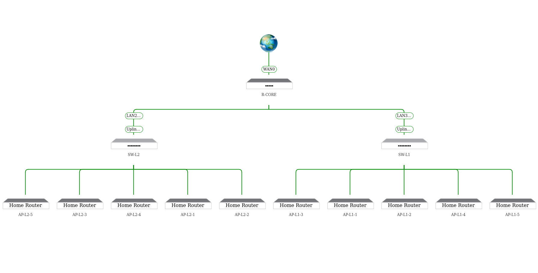

  • 1 x EG105GW(T) for gateway
  • 2 x       ES108GD for switch (1st floor and 2nd floor)
  • 10 x EW1200G-PRO (5x 1st floor and 5x 2nd floor)
This is the topology:
Could you please help me?
Authentication Configuration Troubleshooting Captive Portal Ruijie Cloud

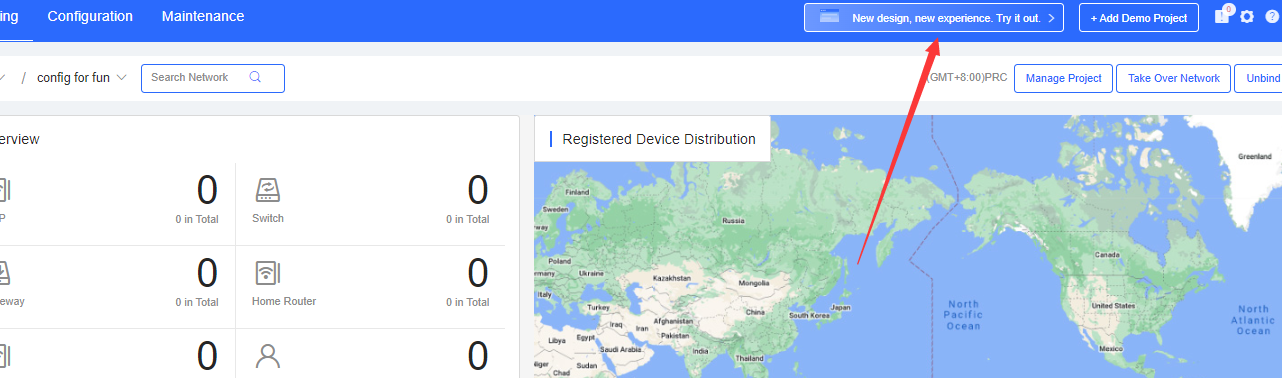

  • Check whether reyee EG has working in the latest firmare version
    if not, you can try to upgrade the device first
  • Check whether there is same error on the new Cloud UI,you can switch to New Cloud UI here

All my Reyee devices is working on the latest firmware.

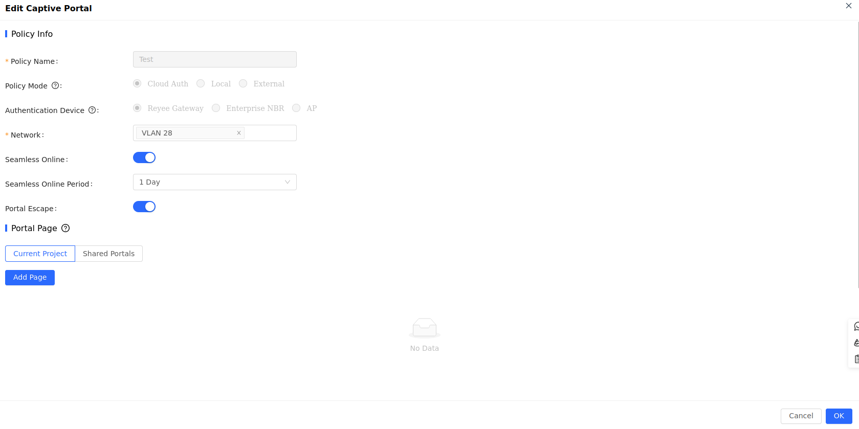

I've configured it in the new design of the cloud dashboard, but in the captive portal menu, I couldn't find any 'portal page' I've already created:
I've found many 'portal pages' that I've already created in the old design on the monitoring >> device >> home gateway >> click SN >> config >> cloud portal auth

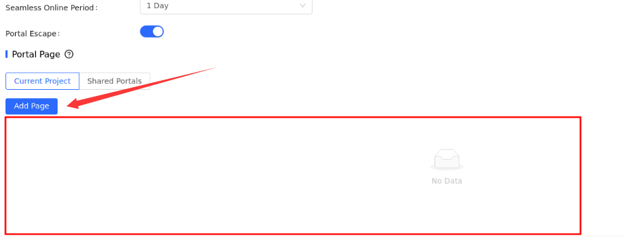

could you try to click add page here?
Ross
0 2024-7-7 16:46:39 View all replies
GTAC-Ross replied at 2024-7-7 16:39

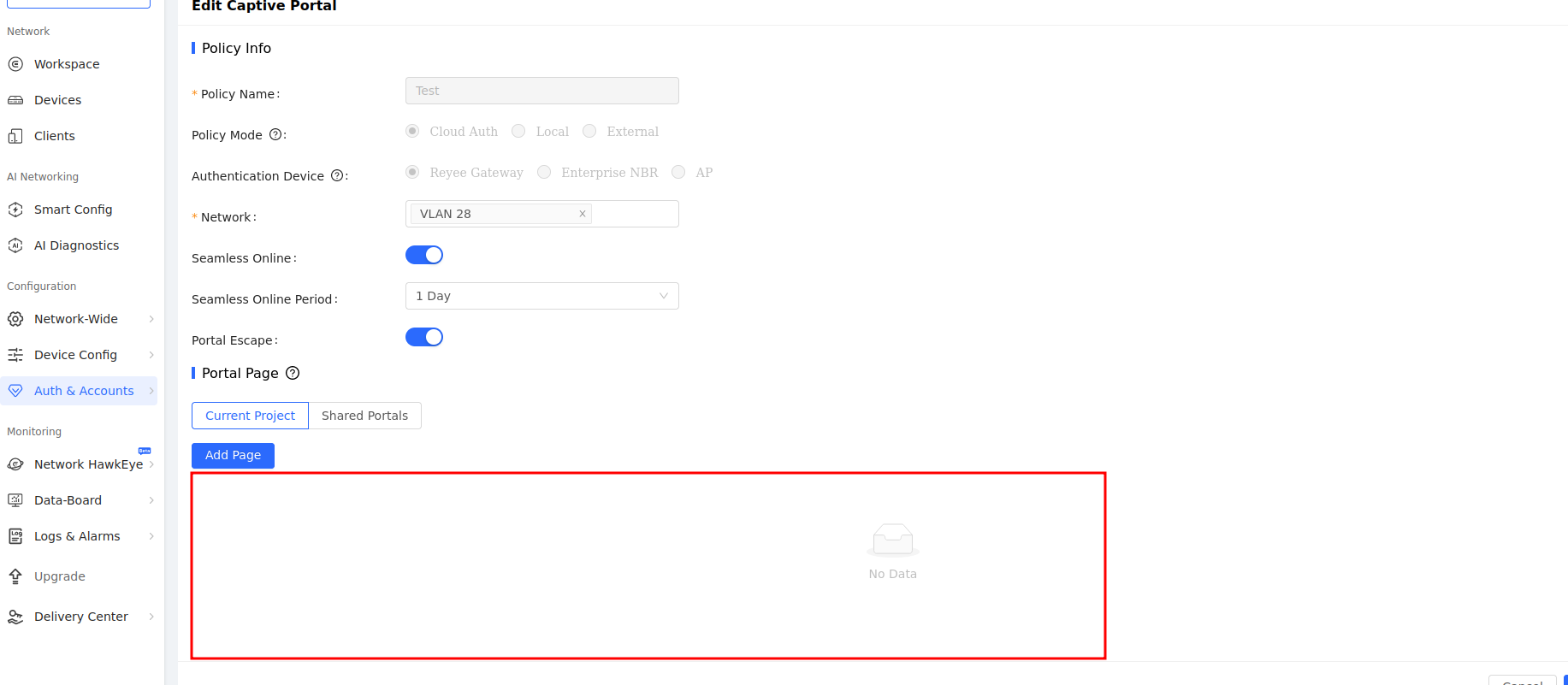

Yes, but not working.
I've many pages that I've already created but not shown in the captive portal menu
At first, I thought it was an error when I created the pages and I tried to create them again, but It still did not show on the cloud portal auth page.
Then when I discovered the old design, I found all the pages that I'd already created in the cloud auth portal menu but with the error: no respondent sam group.

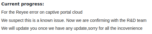

0 2024-7-12 10:40:24 View all replies
So, this is a known issue from Ruijie and is already fixed now.
Thanks
