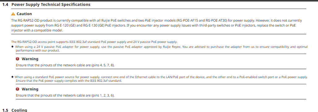

    I got some info that maybe will help us with this topic here:
    https://reyee.ruijie.com/en-global/support/documents/slide_rg-rap52-od-hardware-installation-and-reference-guide#_Ref156910227
    0 2026-7-6 17:14:14 View all replies
    The behavior you are noticing with the RG-RAP52-OD failing to turn on when paired with the RG-E-120(GE) injector comes down to a subtle mismatch in negotiation protocols and pin power delivery methods.
    Why the RG-E-120(GE) Fails to Power the AP
    Even though both devices technically claim 802.3af (PoE) support, they utilize conflicting PoE architectures:
    • Strict Line Sensing Protocol: The RG-E-120(GE) is an older standard 15.4W 802.3af injector designed specifically with an aggressive, hardcoded signature sensing circuit. If the physical connection resistance, line capacitance, or handshake parameters of the connected client do not precisely match what its rigid analog controller expects, the injector acts defensively and keeps the power path shut off to protect what it perceives as a non-PoE terminal.
    • Alternative Pin Configuration (Mode A vs Mode B): 802.3af standards allow power delivery across either pins 1/2 and 3/6 (Mode A) or pins 4/5 and 7/8 (Mode B). The RG-E-120 uses a fixed Mode A delivery scheme. The RG-RAP52-OD outdoor platform relies on a broader, dual-compatibility power circuit built to accept both standard 802.3af and 24V Passive PoE on pins 4/5 (+) and 7/8 (-). The passive sensing architecture inside the RG-RAP52-OD can occasionally fail to respond correctly to the strict analog polling signature sent by older standard Mode A injectors like the RG-E-120.
