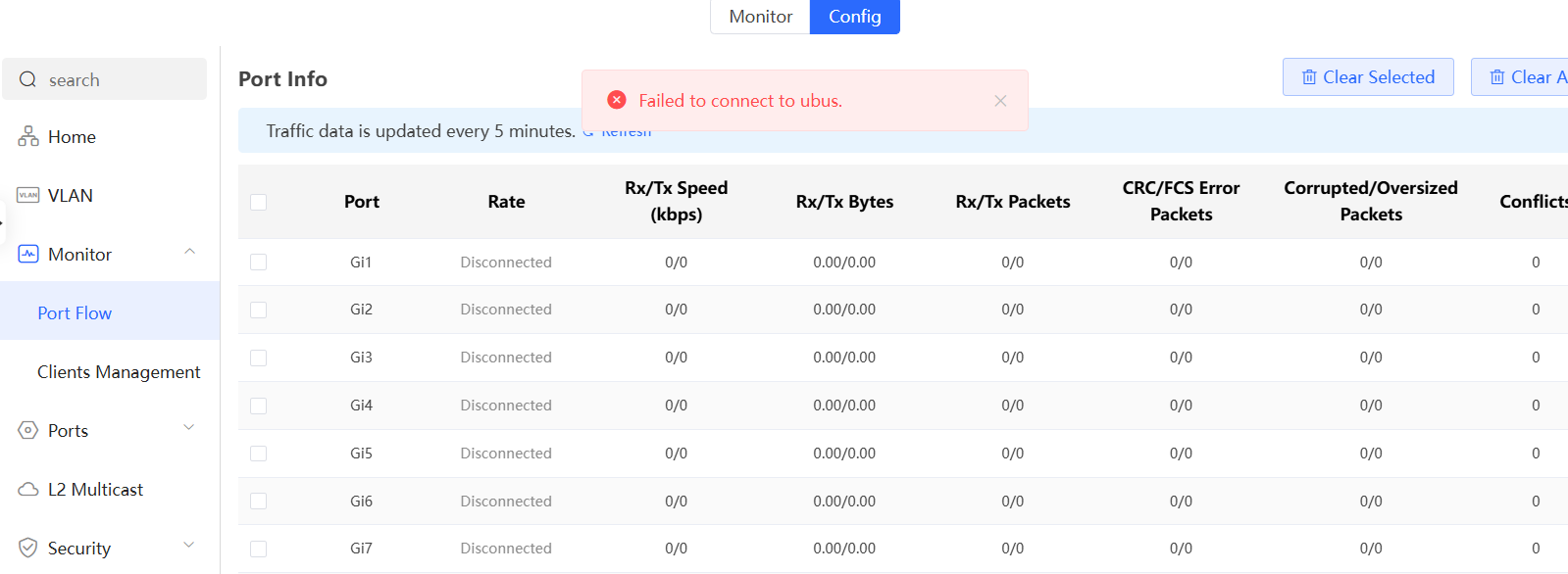

Good Day,
I have a NBS3100-24GT4SFP-P Switch that shows "Failed to connect to ubus" when clicking on any of the tabs in the config.

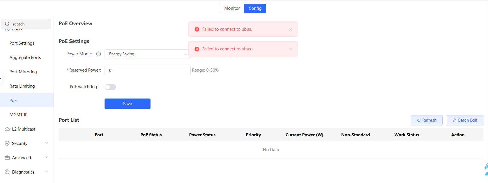

Also i noticed that the POE section is not working. Unfortunately im not close to the site and can only get to the device remotely.
There is no POE Overview as on my other switches in this network.
RG-NBS3100-24GT4SFP-P

Hi sir,
Please try to restart the device and check if it can work. If not, please send SN to my email: chenchunyan@ruijie.com.cn

Hi GTAC-Vivian,
I have rebooted the switch with no luck, so i sent you the serial number via the email address provided.

Hello sir,
Good day!
This needs replacement, plz send your name, email address, receiving address(detailed) to yangyue1@ruijie.com.cn
we will register you RMA case
