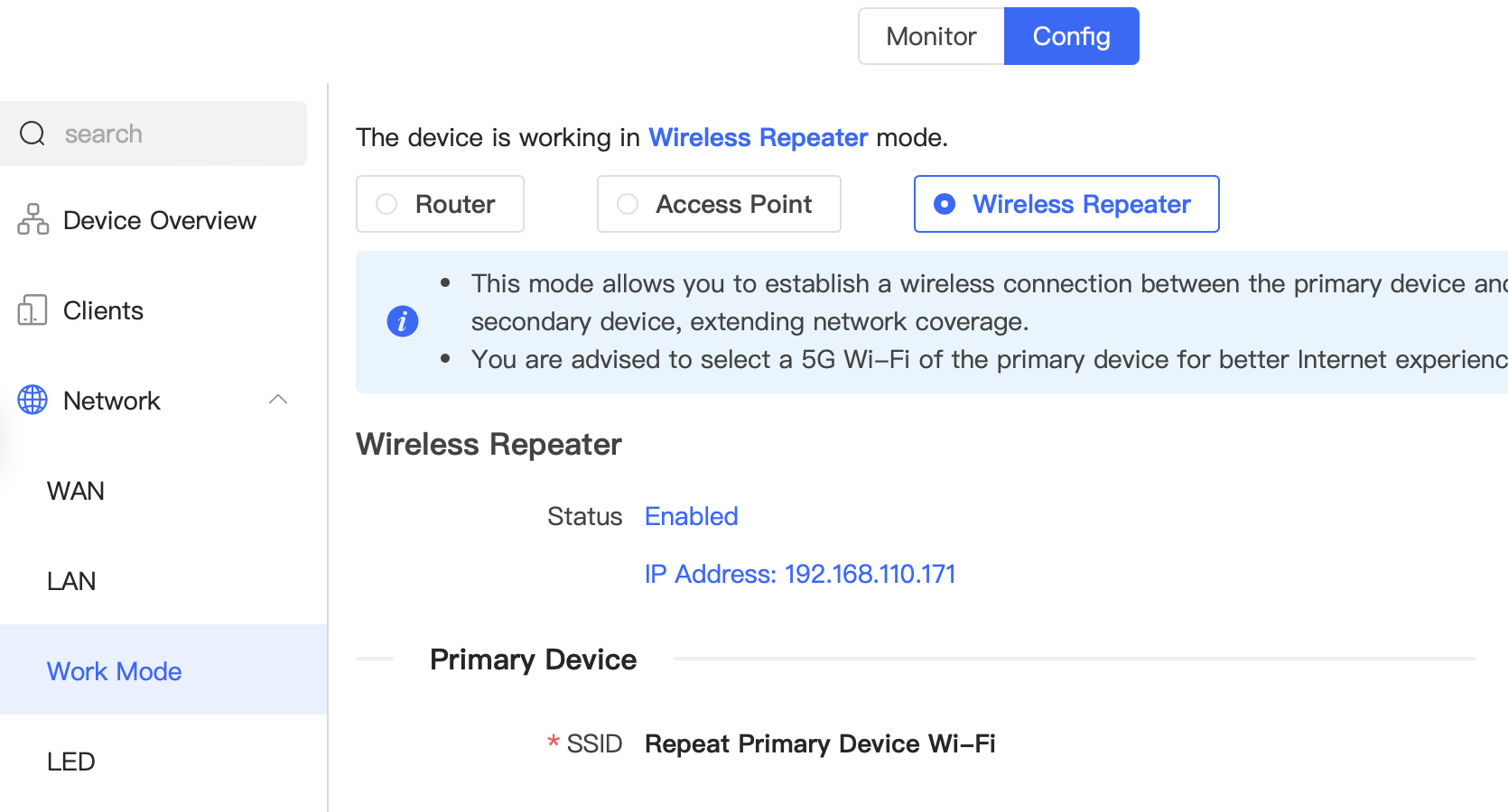

in that case, you can configure wireless repeater mode on the AP
and you can manunlly choose the SSID you want to expand the wifi coverage

I was thinking about it but I'm not on site any longer, can I tunnel into mesh AP and do it without being disconnected to finalise the setup?
It looks like I have to set it up from the scratch.
