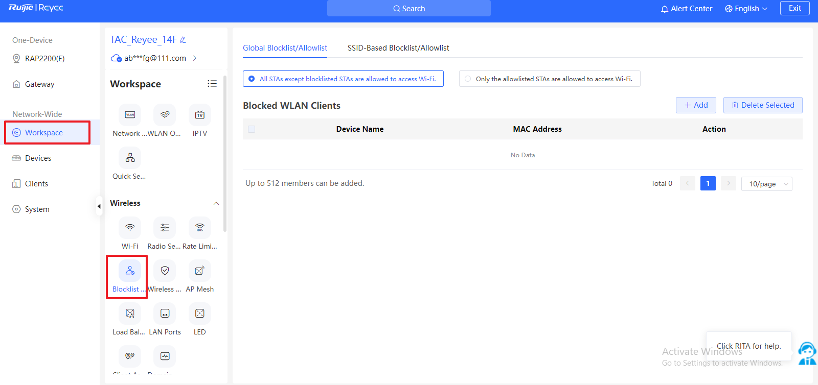

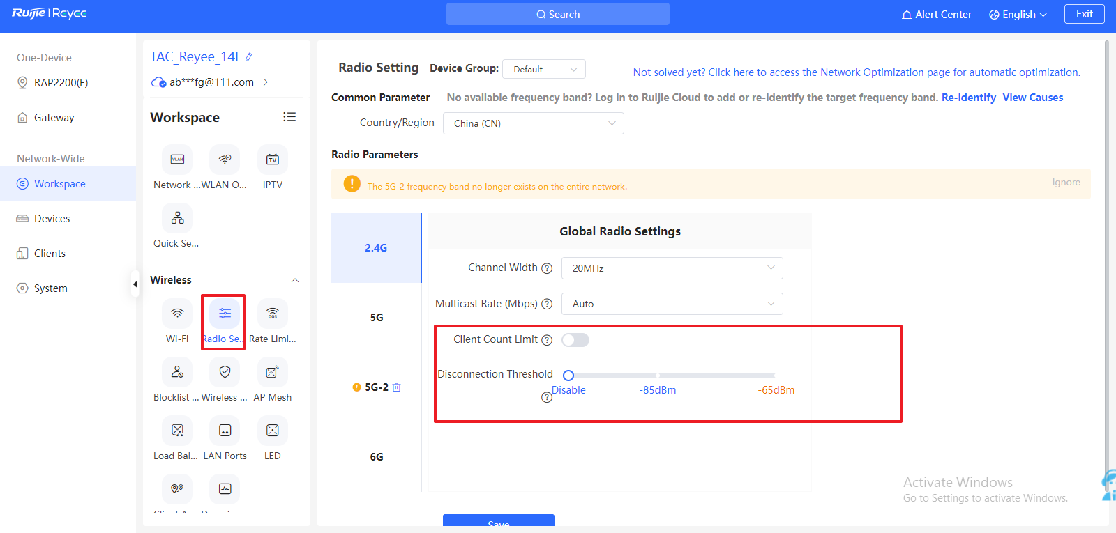

The maximum number of clients of RAP2200(E) is 110 and the recommended number of clients is 40. You can check whether you have configured the sta limit and whitelist/blacklist on the Reyee AP on the following pages:
