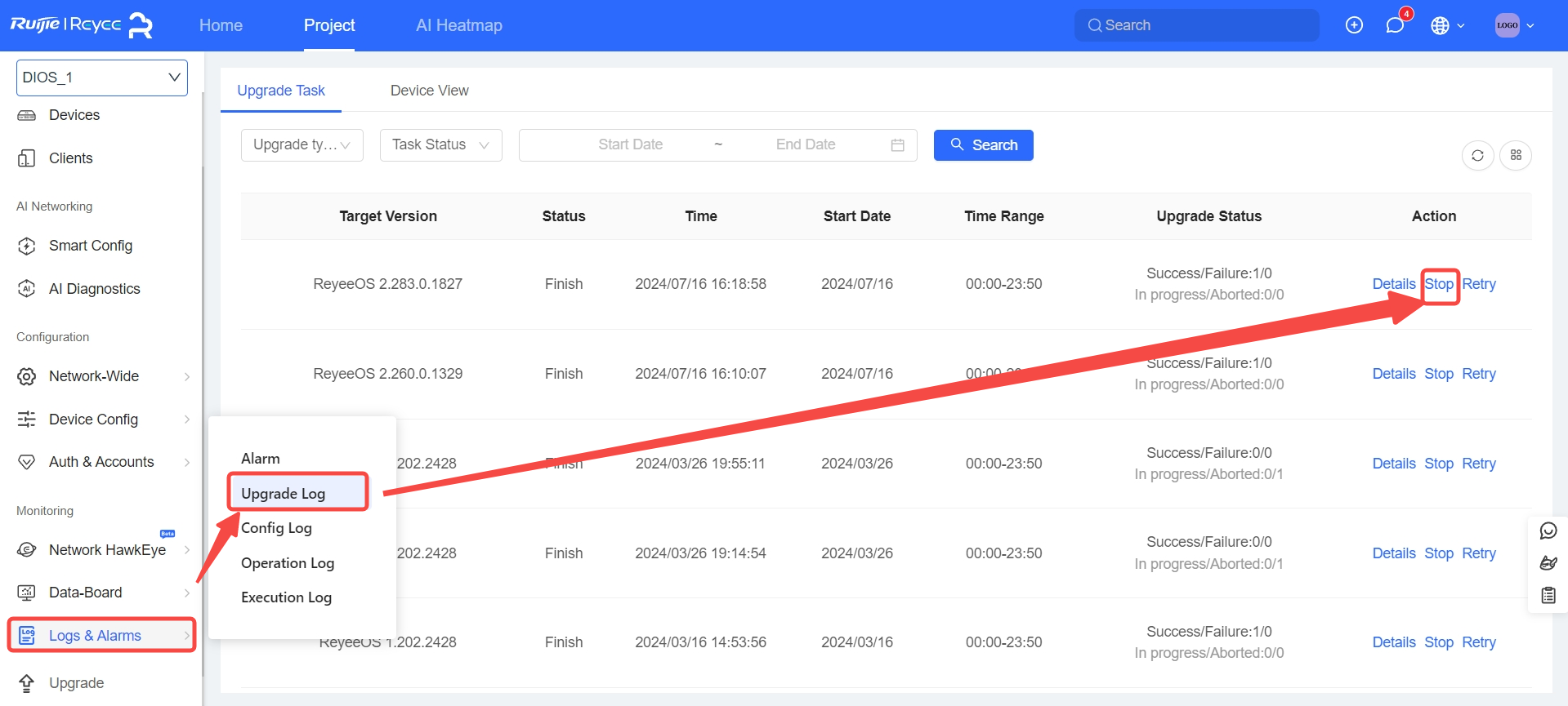

Hi:
can you please stop the upgrading process here:
You can check the avalilable firmware versions in our official website.
If you want to check if the hardware version is compatible, please refer to the release notes on that firmware version.
