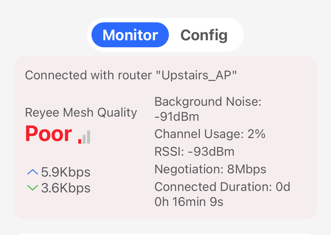

When I'm on the app I can see the quality of the link between AP & Mesh - screen grab attached.
How can I check those parameters on the cloud portal?

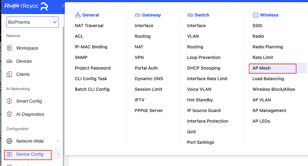

Dear Alexander,
Good day,
You can check the quality of the mesh through the cloud by going to Device Config > Wireless section > AP Mesh option, where you will find the status and quality of the mesh
0 2024-7-19 15:05:36 View all replies

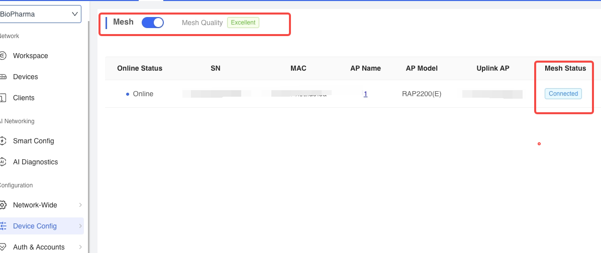

Thank you, that worked like a charm, however, there is an additional issue.
On the cloud, connections are EXCELLENT but on mobile app they are GOOD?

Hi sir,
Please check whether the different quality result display of Cloud App and Web Mesh on the same network and at the same time? If so, please share your network with this service_rj@ruijienetworks.com, and we will arrange a dedicated engineer to troubleshoot and solve the problem for you.
