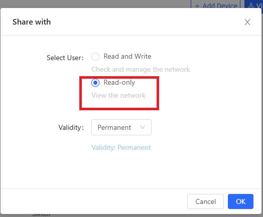

Hello Shahin,
Have you tried sharing your project with your subscribers and set it as read-only? Here is a guide on how you can share your project: https://cloud.ruijienetworks.com/help/#/ArticleList?id=cddfcbde450e4e2b91513831e350202e
Make sure it is set as read-only before proceed.

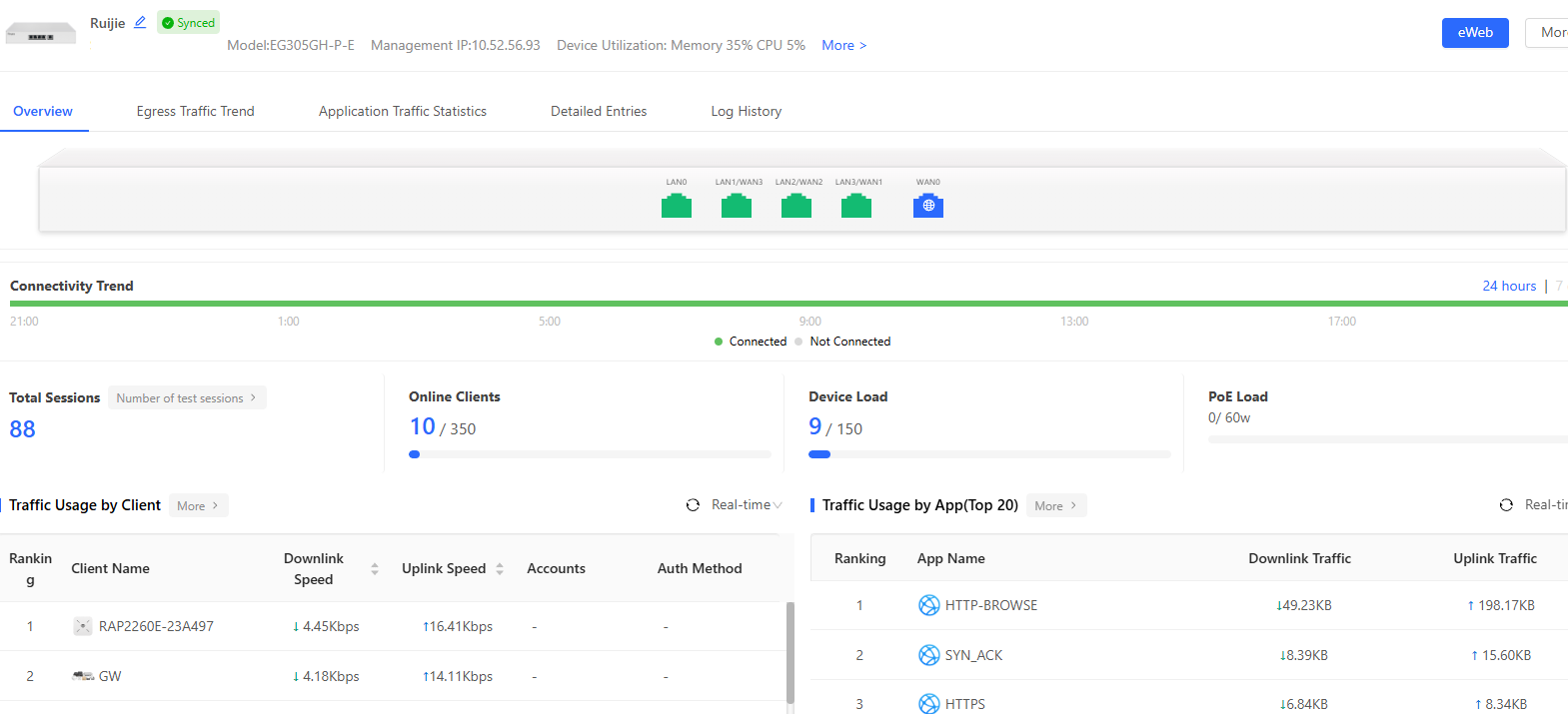

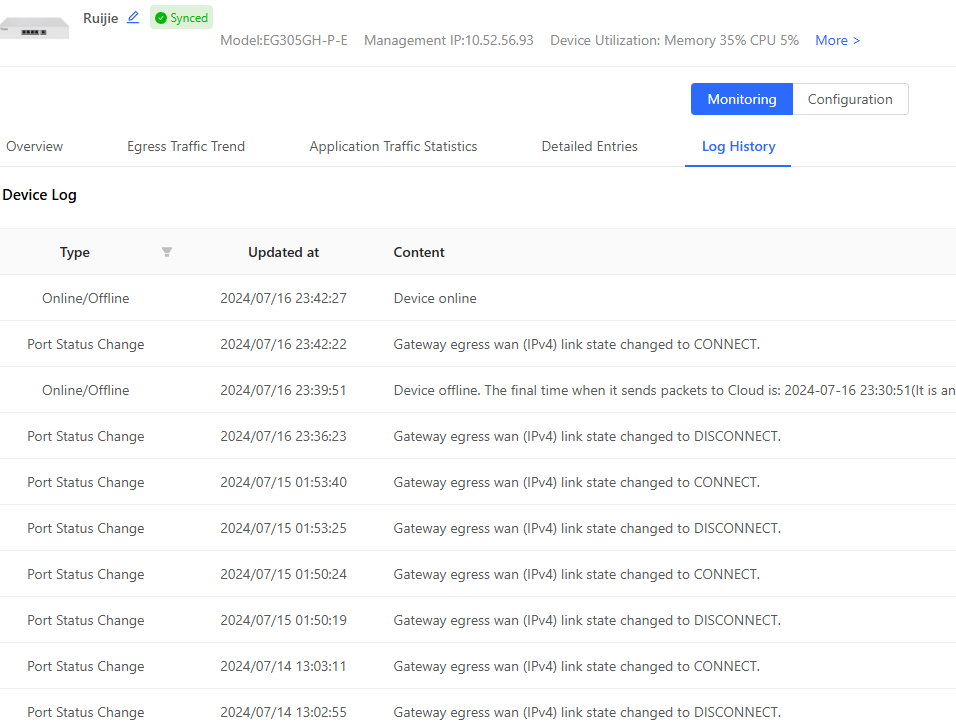

After receiving the project, your subscribers can visit the monitoring panel of your routers. And they can view the traffic usage, log history, etc.

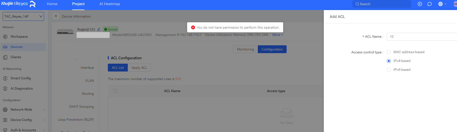

Should anyone without writing privilege try to configure the network, a "permission denied" message will be prompted.
