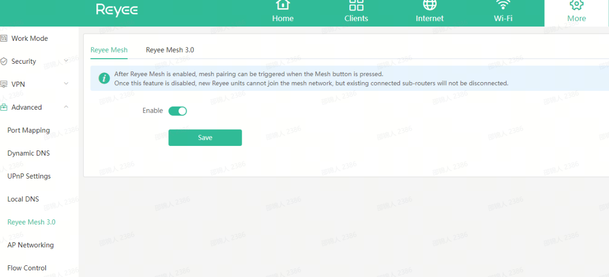

When setting up the network through Reyee Mesh, make sure the AP device has been restore to factory setting by pressing and holding reset button. If an AP device has been added to a network before, it would be assigned with a network ID and thus won't be detected.

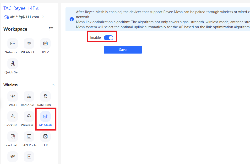

Furhtermore, make sure the AP Mesh function is enable on both your AP device and router.

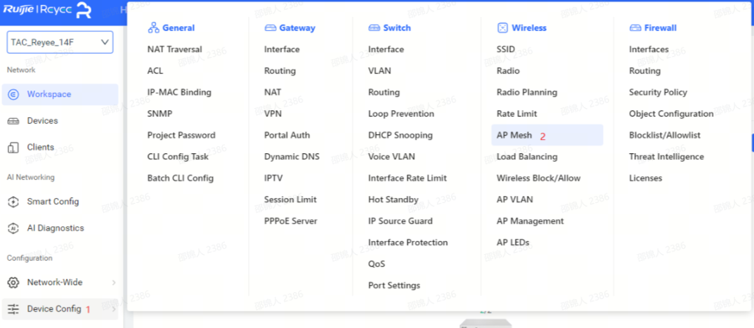

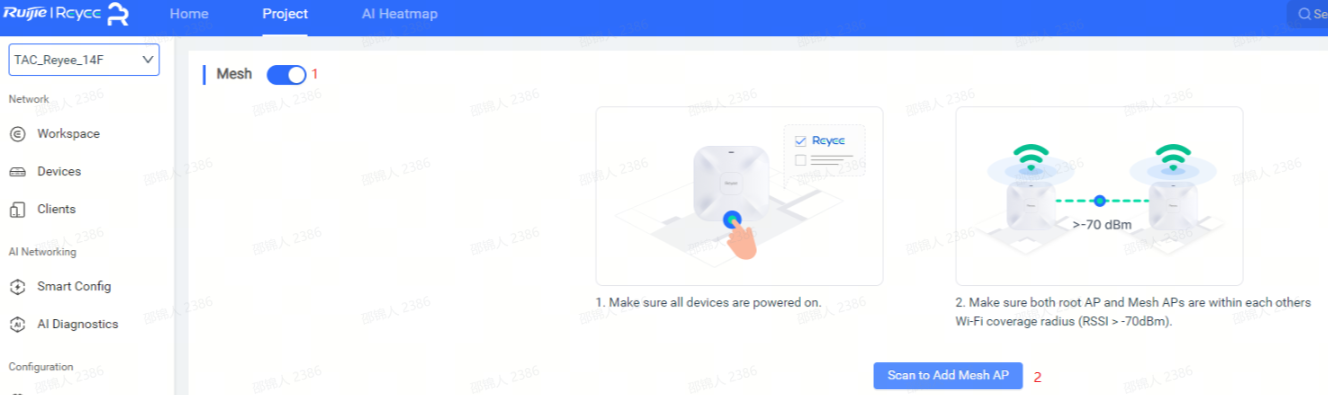

It is also possible to configure AP mesh through Reyee|Ruijie Cloud. After resetting and plugging the it, you can go to device config > AP Mesh page.
Toggle Mesh and click scan to add Mesh AP to search the AP device.
