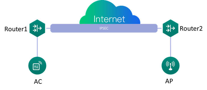

An AC isdeployed at the headquarters of a customer, and an AP is deployed at a remotebranch of the customer. An IPsec VPN tunnel is established between the egressrouters at the headquarters and branch, and the AP communicates with the ACthrough the IPsec VPN.

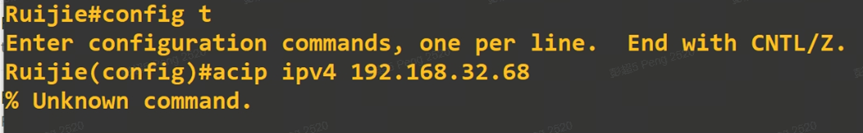

When the user runs the acip ipv4 (AC IP address) command on the AP to obtain the AC IPaddress, the following notification is displayed:

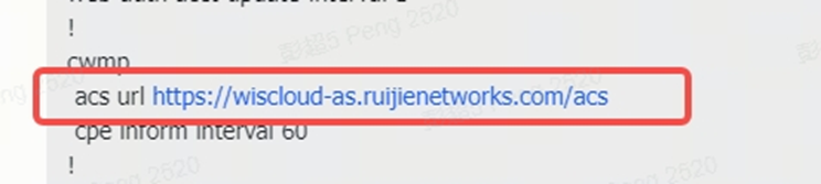

5. Manually switch the AP to Fit mode, restart it, and verify if it remains in cloud mode. Upon reviewing the AP configurations,WIS Cloud settings are found. It is suspected that the AP has been online onthe WIS Cloud and is still bound to the WIS Cloud. During startup, the fit AP communicates with the WIS Cloud, and automatically switches to the cloud modeafter successful communication.
3.Solution
After the customer logs in to the WIS cloud, unbinds the AP, and switches the AP back to fit mode, the AP successfully goes online.
