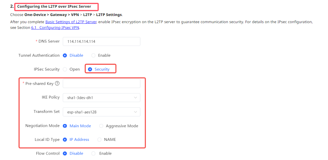

How can i connect to l2p over ipsec as client to Mikrotik l2tp ipsec server, from EG105G-V3
Configuration Ruijie Cloud
0 2024-7-28 18:12:54 View all replies
You can refer to this guid to configure L2TP over IPsec VPN on the Reyee EG
https://reyee.ruijie.com/en-global/support/documents/slide_ruijie-reyee-rg-eg-series-routers-implementation-cookbook
note:both ends should use the same protocol IKV1 or IKV2
one the server ends it will need a public ip address or port mapping will need to be configured on the uplink device
