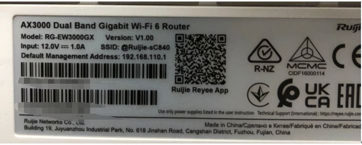

2.3 The Power Adapter Is Non-Original, Resulting in Insufficient Power Supply
If the output power of the power module is abnormal, the router emits abnormal Wi-Fi signals and the LED blinks for a long time. In this case, check
whether the power adapter is original, and whether the current and voltage values on the power adapter match those on the label at the bottom of the router.
