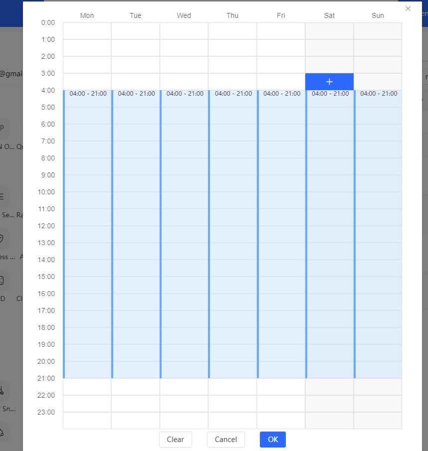

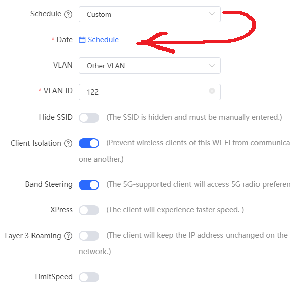

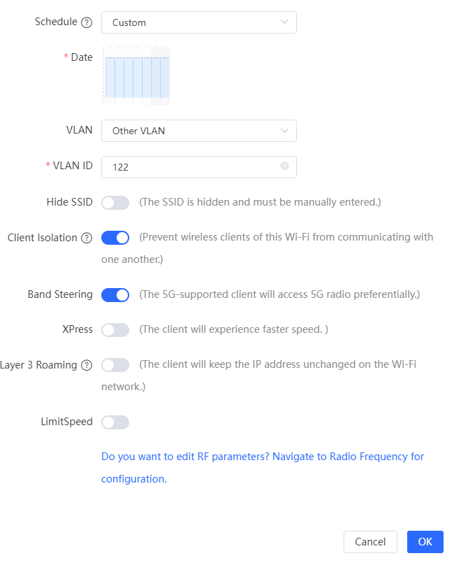

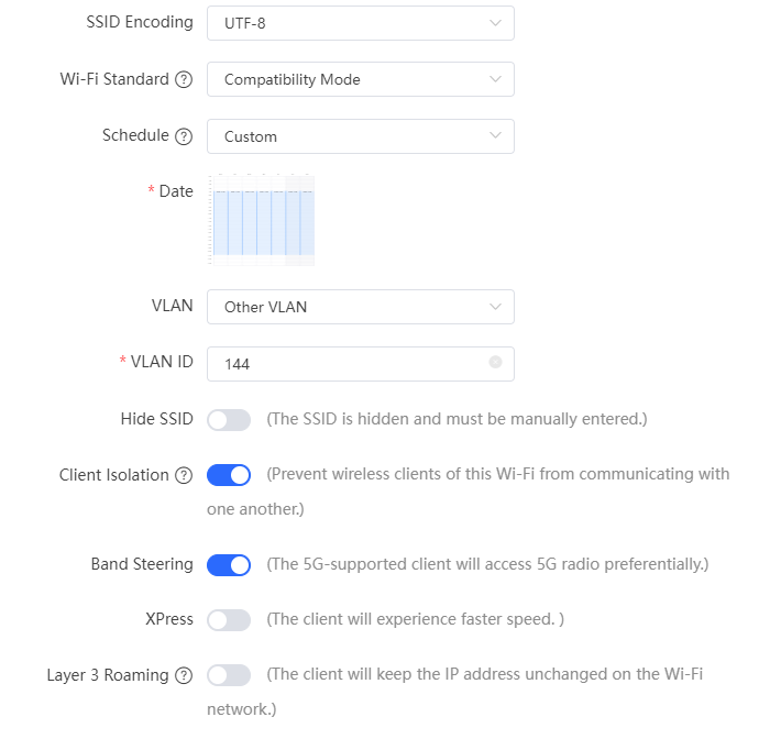

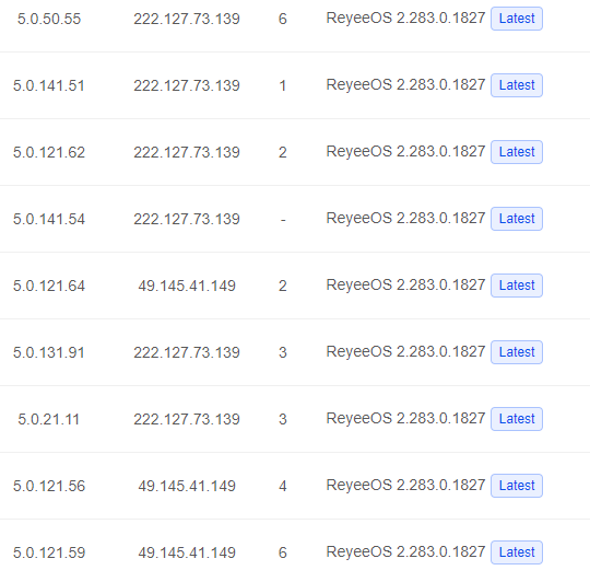

Yes i follow the same instruction that you give me..
Firmware Version:
sysinfo.@sysinfo[0].software_version='ReyeeOS 2.283.0.1827;AP_3.0(1)B11P283,Release(11182719)'
. Device Model: RG-RAP2200E and RG-RAP6260G
.this is what i did
