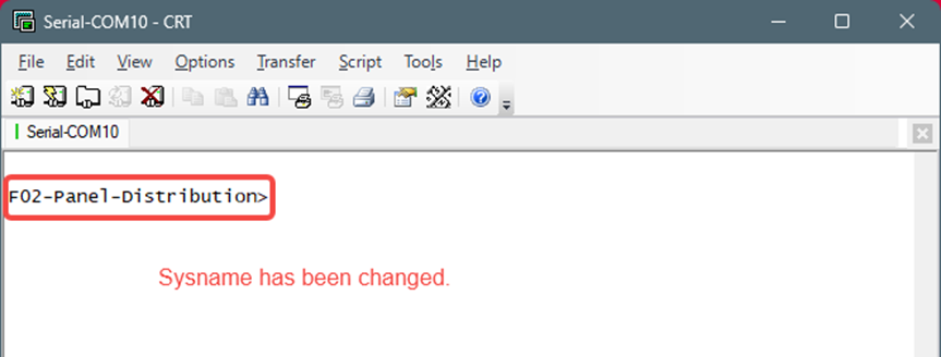

4. Root Cause
After logging into the switch, the user discovered that the switch was not using the default configurations. Specifically, the port IP address is a static IP address, preventing access to the switch’s web management interface through aweb browser using the default management IP address. Additionally, the switch cannot acquire an IP address automatically.

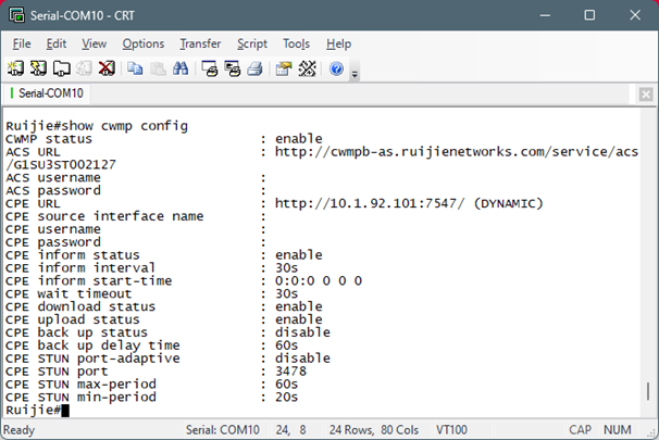

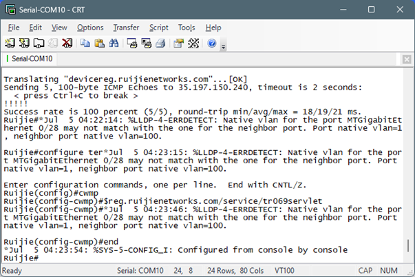

Delete flash:/ config.text
Reload
After the system reset, the switch was restored to the default configuration. The switch port successfully acquires an IP address, enabling normal internet communication. Next, CWMP configuration is complete, and the device is onboarded to the cloud.
