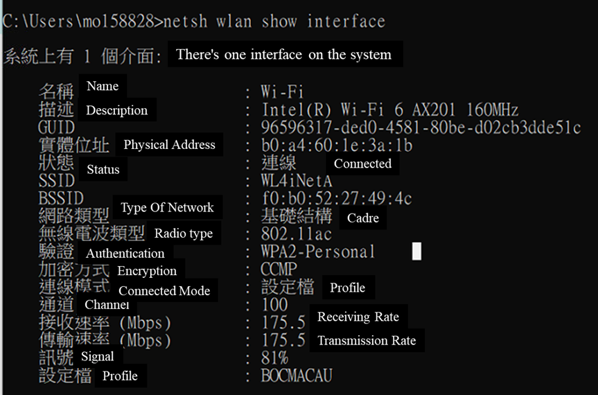

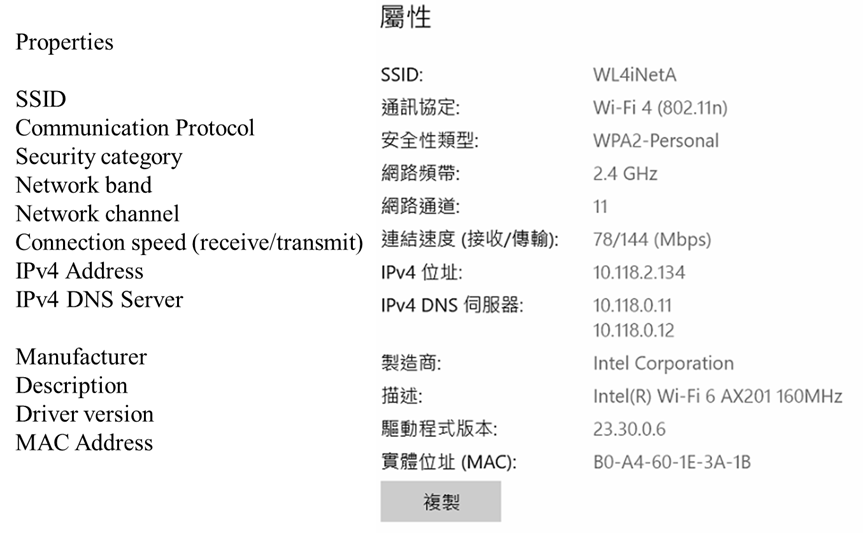

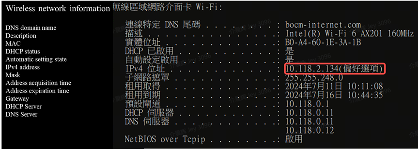

1. It is verified that the configurations on the web interface are correct, and the output of the show black-white-list config command confirms that the configurations are correct and take effect. Despite this, the client (alaptop) whose NIC is on the blocklist can still connect to the SSID and obtainan IP address.

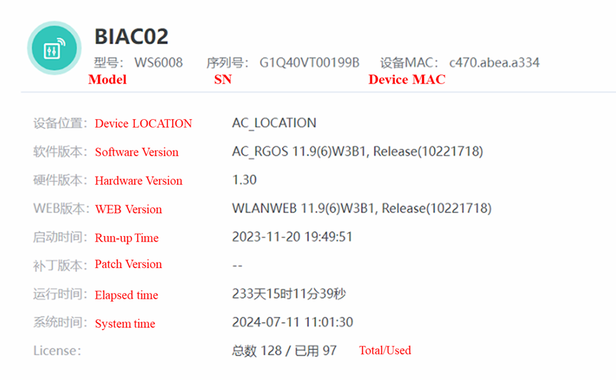

2. The AC model is identified, and the AC uses the latest firmware version.

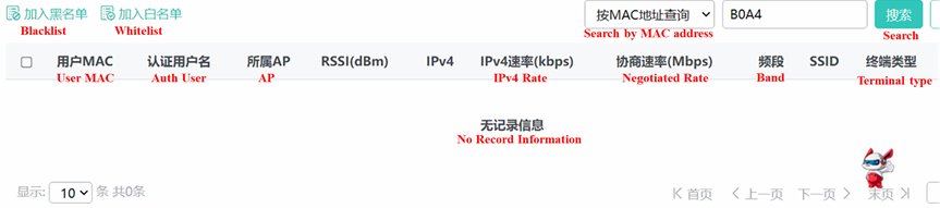

3. The client's MAC address cannot be found on the AC's client list.
4. Root Cause
Locate the BSSID (the connected AP) by checking the WLAN information on the client.

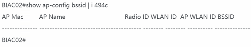

It was discovered that the AC does not manage the BSSID. Consequently, the blocklist configuration on the AC does not apply to this BSSID. The SSID-based blocklist only functions when the client connects to the specified AP through which the AC delivers related configurations. Therefore, the client in question remains unaffected by the blocklist because it is not connected to the designated AP.
