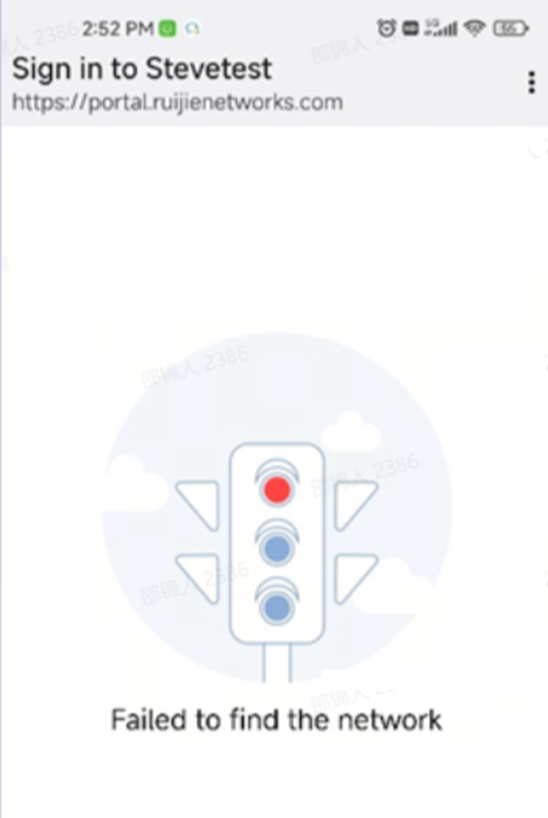

2. The authentication page could not be loaded.

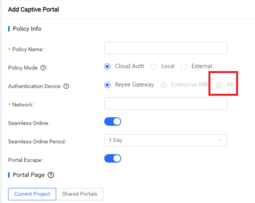

2.1 Check if the model supports captive portal authentication
If the authentication device is set to AP mode, make sure the RAP/Reyee EG in your network supports the AP portal feature.Currently, only EG300 Series and following models of RAP support this feature:
RAP1260/RAP1261/RAP2260/RAP2260(E)/RAP2260(G)/RAP2260(H)/RAP2266/RAP6260(G)/RAP6260(H)/RAP6262/RAP6262(G)

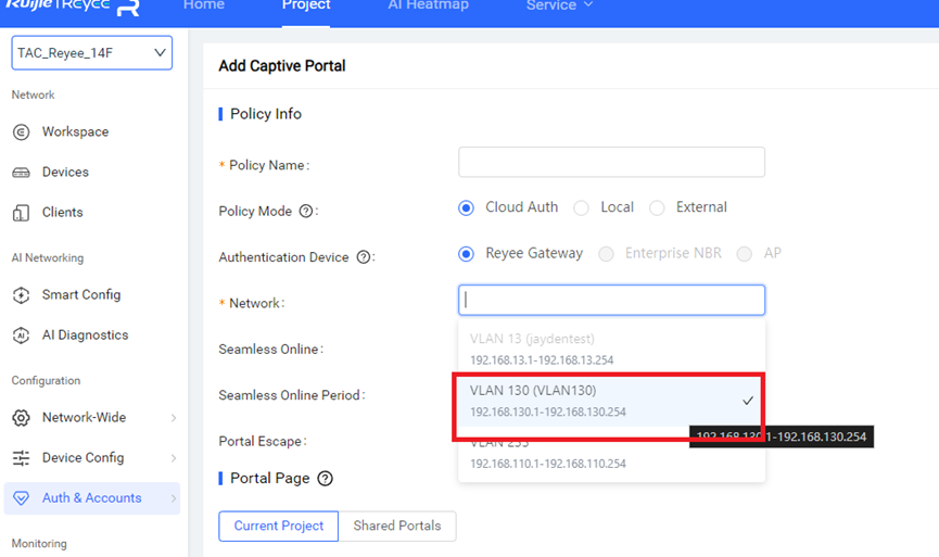

2.2 Check if the portal configuration is correct.
Make sure your user device is connected to the VLAN set in the portal

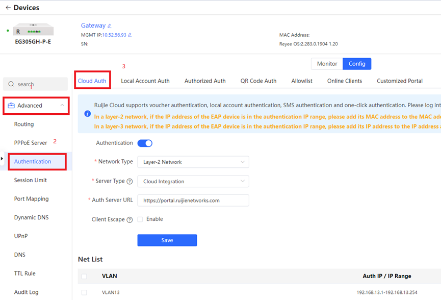

Get into the eWEB of your gateway, and check if the authentication settingis correct (Please refer to the image below):

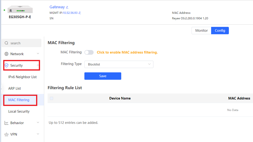

Check if the user device is in the blocklist of your gateway in the eWEB
2.3 Check the connectivity of your user device.
After connecting an user device, check if it can ping "portal.ruijienetworks.com"or visit "https://portal.ruiiienetworks.com" via a browser.
If it is only some of devices that cannot load the portal page, try visit"1.1.1.1" via browsers and see if they can be redirected to authentication page,
