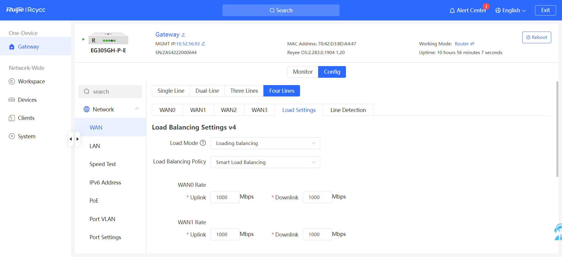

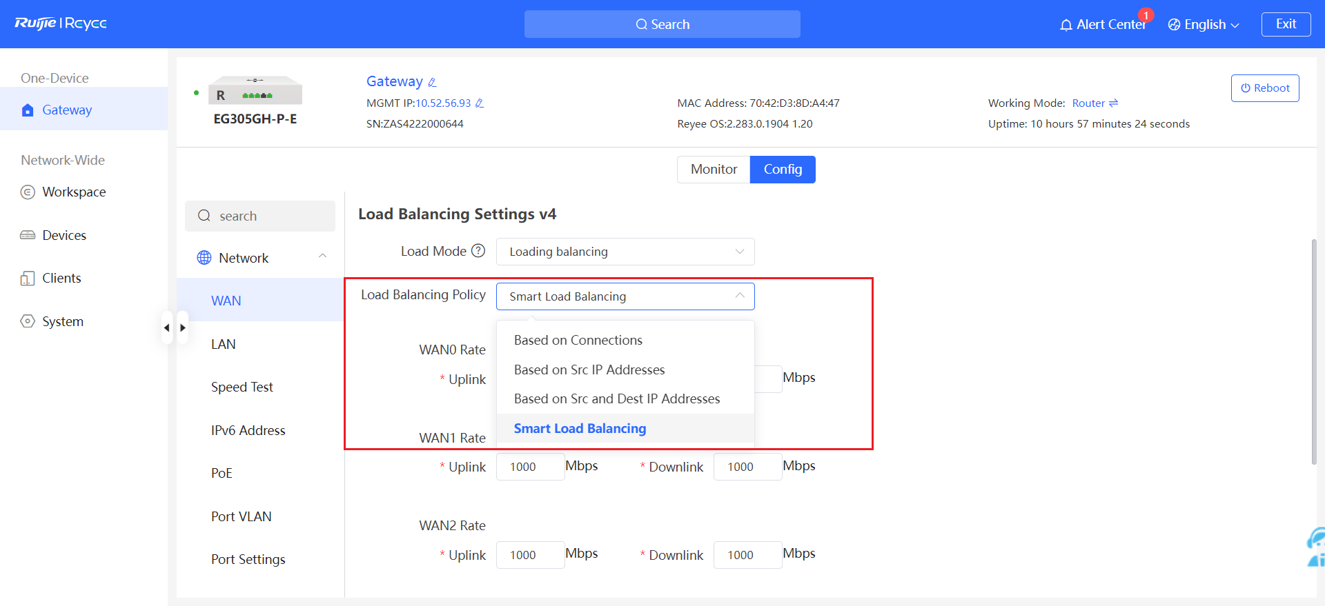

Hi sir
For this situation , you can check your load balance config.
Step 1. check the load balance mode.
Step 2. check the load balance policy .Different policies will prevent traffic from being loaded to other links.

AH ok - let me try that.
Also, i don't have any polices loaded - are there any default policies i should change OR if i didn't add it should be clear?

Thank you working MUCH better!
