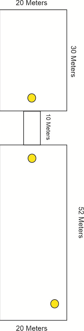

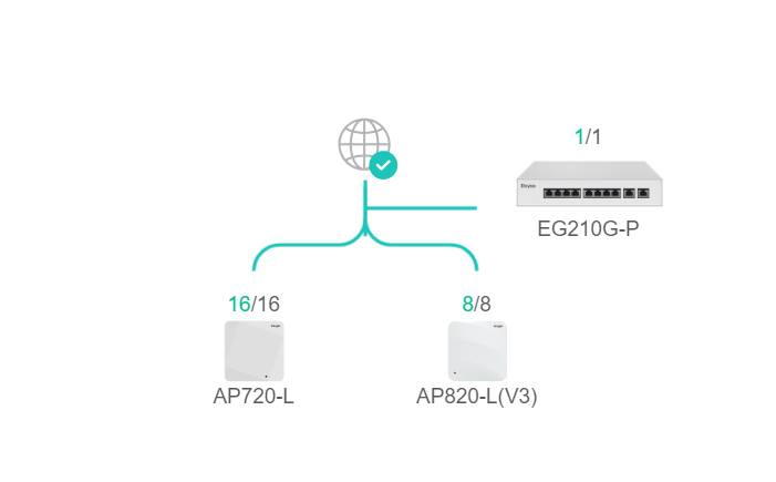

I Have
Ruijie 720-L16
Ruijie 820-L(V3)8
This is the topology
And this is sample of installation maps in building 1 (the yellow is AP)

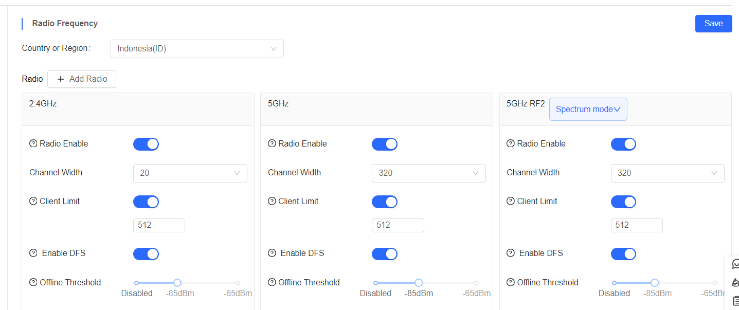

Did you check the Radio Settings? Could you please take a screenshot? Also did you do wifi optimization on cloud?
All aps broadcast the same ssid and the users are on the same network segment, right? How did you test roaming?  Could you please record a video of the test process?
Steve
0 2024-8-7 12:00:31 View all replies
GTAC-Steve replied at 2024-8-7 10:51
Hi sir,
Did you check the Radio Settings? Could you please take a screenshot? Also did you do wif ...
this is radio setting
wifi optimization already done.
i just use ping tools for test the connection and roaming.

Hello,
Can you help to check power and Roaming Sensitivity? Here is the path
Depending on your topology, if APs are only 10 meters apart and have walls. To avoid interference, you can try to adjust the power to about 60%-70% and test
If the distance between APs is 52 meters, the distance seems too far for the AP to cover.  For example AP820-L(V3) coverage is circle with 20-meter radius. If you set power as 100%, it means it can only cover 20meters.
