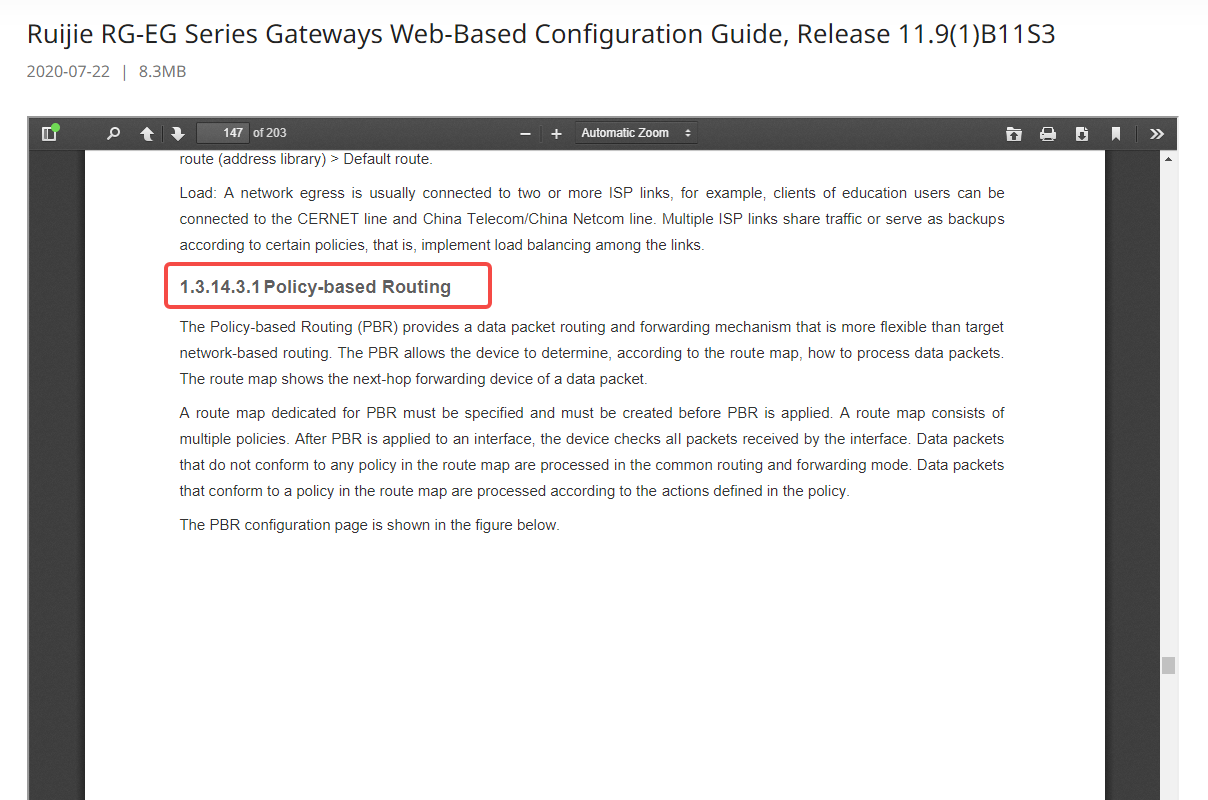

Hello Mr Vitaliy,
Fro this case you can configure a PBR to specify the route of every lan and vlan. You can look into this guide for the PBR configuration on page 147
https://www.ruijienetworks.com/resources/preview/76379
