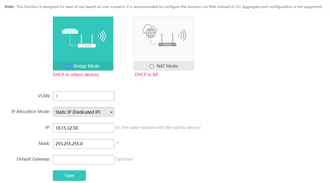

hi there my home not using vlan, just using mikrotik as router and broadcast dhcp, the issue is i cannot setup AP Ruijie 820 L v3 as access point.
AP-820-L(V3)

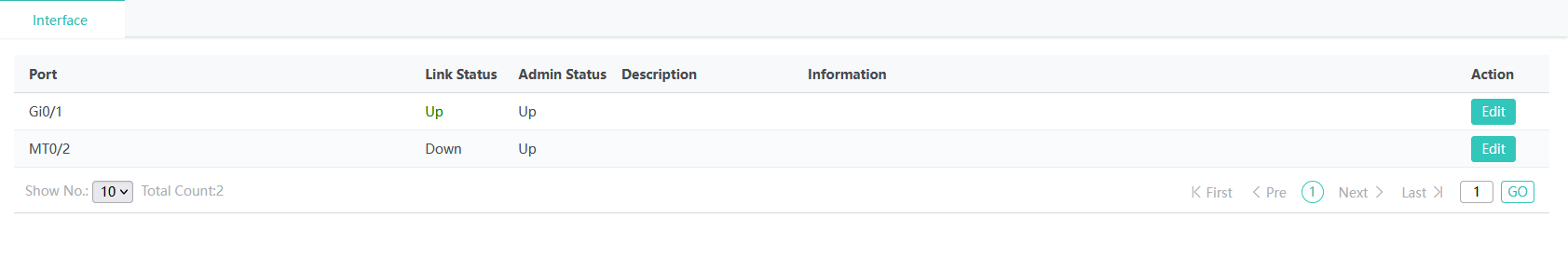

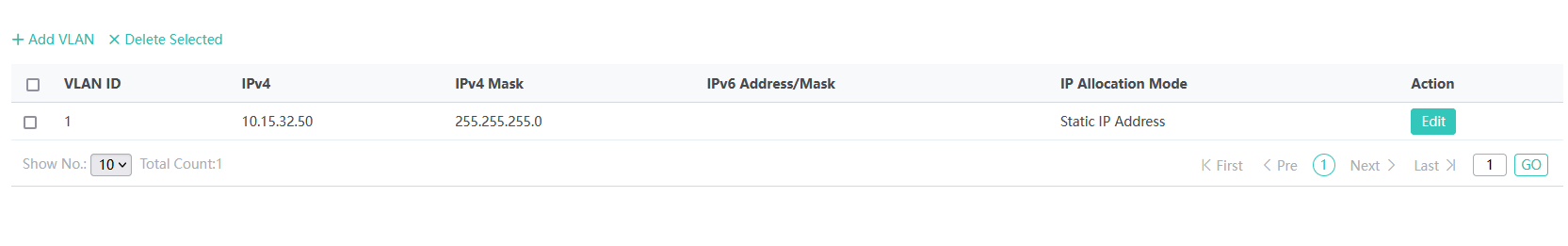

Hi Jayden,
thanks for reply,im not an IT guy so dont know how to explain in IT need help please:
my access point is AP 820-L (v3) i need to configure as an access point only not as router so i choose as FAT mode but it doesnt working:
my configuration:
with this configuration my laptop cannot get ip address from router via access point
0 2024-8-8 16:44:25 View all replies

Hello,
I‘m sorry that we can't provide a specific solution for you based on current information. May I ask who the DHCP server is?
If the AP will act as a DHCP server, then you should choose NAT mode.
If the AP only broadcasts the SSID and there are other devices on the network acting as DHCP servers, can I see the configuration of the server?
If you set static ip on user, will user ping gateway or 8.8.8.8 noramlly? If yes, pls help access gateway device and capture packet for us so that we can help you analysis this issue. If not, we can check gateway(DHCP server) and other device( like switch) configuration.
