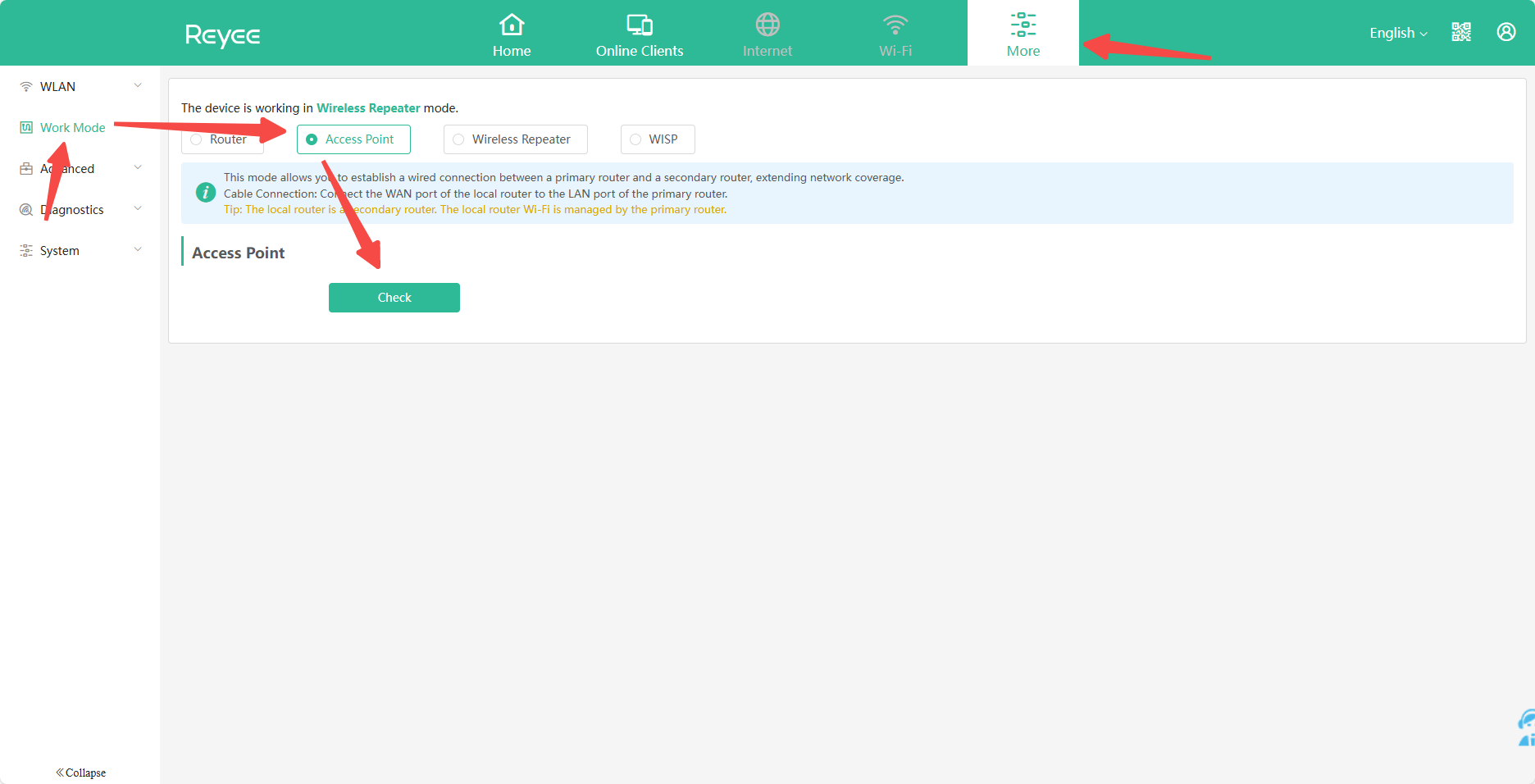

Hello Rizki,
As my partner Ross says it, the mesh only can be stablished between devices of the same family, this means, EW devices with EW devices, RAP devices with RAP devices. Antoher importan thing that could help you is connect the EW1200 device and modify the working mode to access point. with this configuration the device going to receive the same SSID configured in the EG and working in the same network.
to do this just need to go to web management of the EW and follow this image
Is there are any doubt please let us know.
Best Regards
Saul

2 tahun pakai RG-EG105GW(T) tapi saat ini ada blankspot, jadi saya membeli RG-EW1200 untuk mengatasinya. Jika mesh tidak bisa artinya terdapat 2 pilihan, mode wireless repeater atau mode aksespoint. Karena otentifikasi pengguna menggunakan voucher, sepertinya akan bermasalah jika menggunakan mode repeater. Di router utama hanya terbaca IP address repeater, bukan klien. Kesimpulannya, cuma ada satu pilihan; mode aksespoint. 😑 (via kabel)
