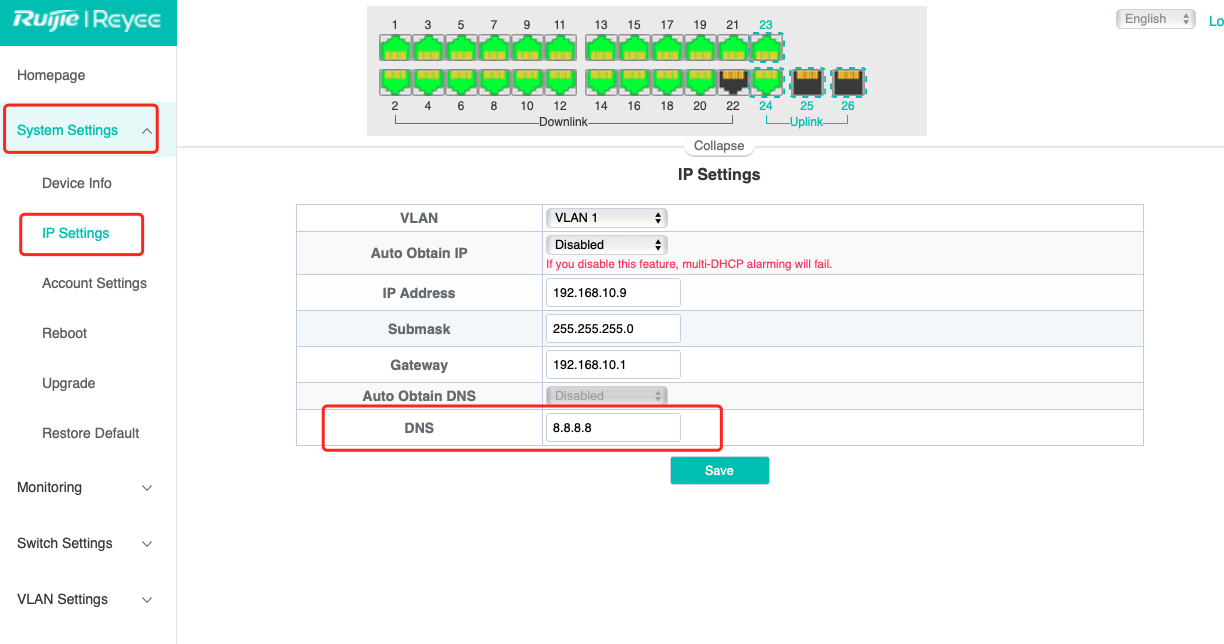

The switch cannot connect to the cloud even though it is connected to the internet.
the domain it is using is iotsvr-as.ruijienetworks.com:5683 to connect to cloud management
RG-ES218GC-P

Dear Ken,
You may try amend your DNS Server as 8.8.8.8 in the eWeb of the ES switch, it supposed to work.
Regards,
Lex

thanks it really works
