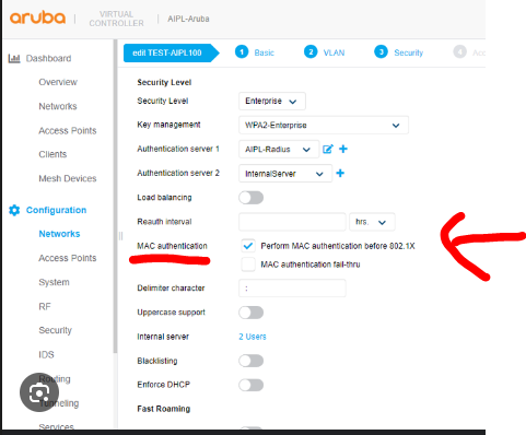

Hello,
We have more than 5000 Mac addresses that need to be controlled.
And seems only 3000 Mac addresses are supported by the AC.
We do believe a separate Radius Server is needed for this case.
Can we have a sample setup step like the Aruba IAP?
