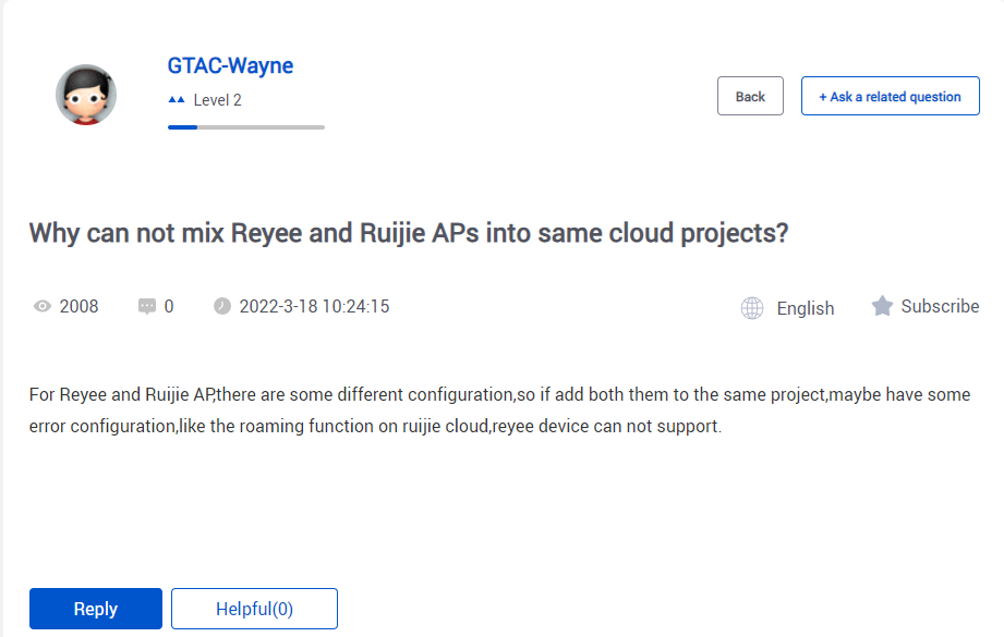

Thank you. I asked the question because I cam across this post. So whatever issue mentioned in it has been resolved?

Thank you. I asked the question because I cam across this post. So whatever issue mentioned in it  ...
Hi sir,
What I mean is that you can add reyee AP and ruijie AP to a project, which is no problem, but because reyee and ruijie AP have different functions,it is not recommended to add them in one project.
