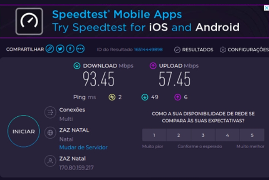

The following figure shows the speed test results when no rate limits are configured.

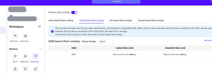

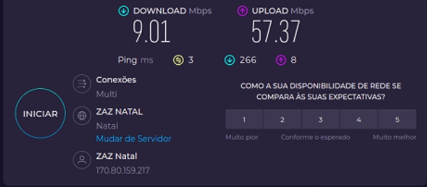

When the rate limit is set to 10 Mbps, only the downlink rate limit is enforced, while the uplink rate limit does not take effect.

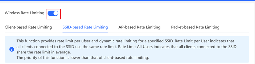

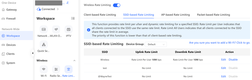

To enable the wireless rate limiting function on a RAP device, follow these two steps:
1. On the Wireless Rate Limiting page, configure the rate limits. The value is set to No Limit bydefault.
2. Toggle on Wireless Rate Limiting.
If the rate limits are configured but the function is not enabled, the settings will not take effect.

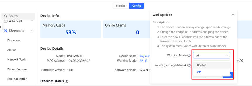

1. When the RAP device works inAP mode, both the uplink and downlink rate limits are effective.
2. When the RAP device works inrouter mode, only the downlink rate limit is effective.
