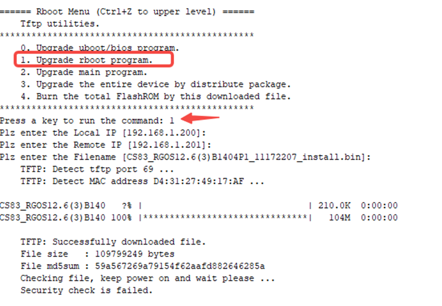

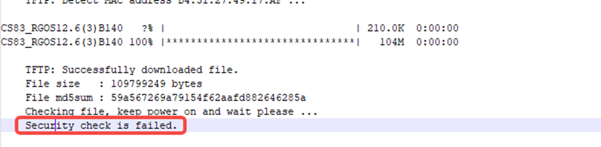

The following notification is displayed after a boot-based version upgrade fails on the RG-CS83-24GT4XS-P:
1. Device Model and Firmware
  Device Type
  Device Model
  Firmware Version
  Ruijie  switch
  RG-CS83-24GT4XS-P
2. Cause Analysis

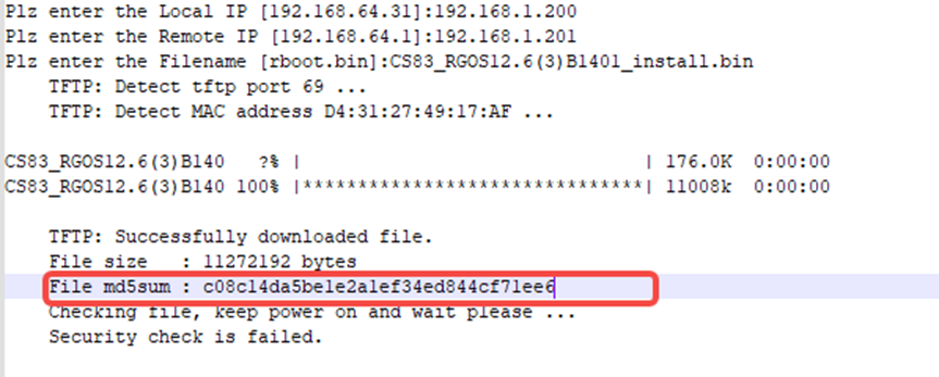

1. From the operation logs, the upgrade mode is incorrectly selected. ‘2. Upgrade main program’ should be selected for a system upgrade. However, ‘1. Upgrade rboot program’ is selected instead.
2. After 2.Upgrade main program is selected, the upgrade still fails. Check if the version file is complete.

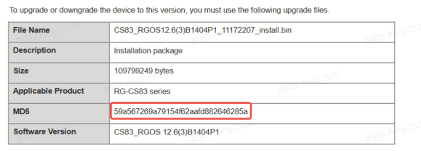

(1).Check the MD5 checksum after the version file is uploaded.
(2) Compare it with the value in the release notes.
The two values are inconsistent, indicating that version file may have been damagedduring the upload.
3. Solution
Download the version file again and perform the upgrade operation again. The upgrade issuccessful.

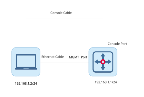

Ⅱ. Topology
II. Configuration Notes
1. Use adedicated console cable to log in to the switch, with the baud rate set to 9600.
2.Connect the Ethernet cable to the MGMT port of the switch. (Note: When the switch is connected to the PC via an Ethernet cable, the port status LED on the switch will not light up, and you will not be able to test the connectivity between the PC and the switch. The port status LED will only light up when there is data transmission.)
If the switch has a MGMT port, connect the PC tothe MGMT port. If the switch does not have a MGMT port, connect the PC to the first port on the switch.
