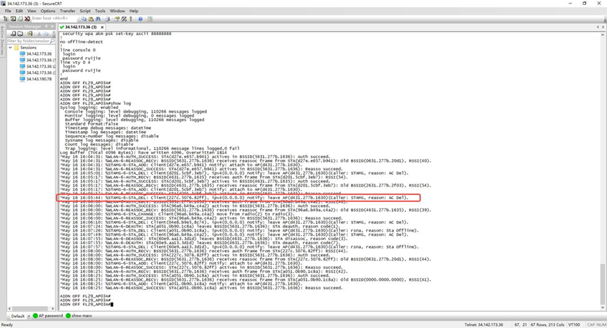

1. Check for signal interference among APs and their placement in the environment. It is found that the APs are placed too close to each other, resulting in high channel utilization.

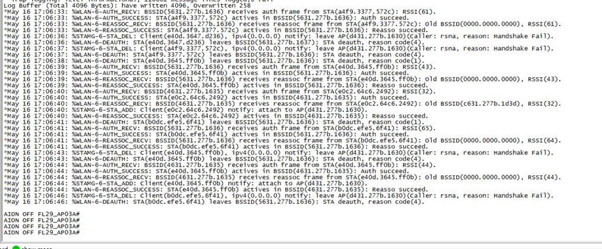

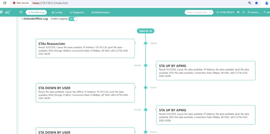

2. Check the client association logs on both the AP and the AC for wireless clients experiencing issues. The logs reveal abnormal IP address acquisition problems for these clients.
Show log
showwlan diag sta sta-mac x.x.x
Enable DHCP snooping on the AC and check DHCP information for the wireless clients.The DHCP process appears normal.
Upon further inspection of client logs on the AP, numerous "handshake failed" entries were found, indicating an issue with the firmware version.
