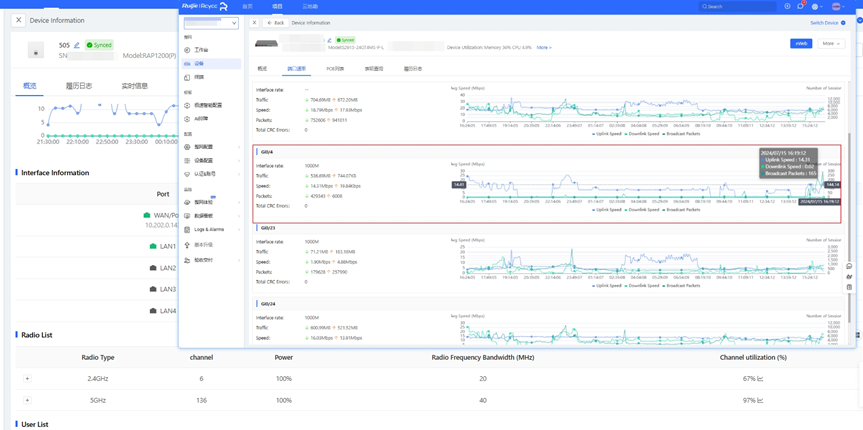

1. Check the multicast configuration and multicast traffic of the switch at uplink ofthe RAP. It is found that multicast is not configured on the switch, resulting in multicast packets being broadcast to the RAP. The multicast traffic, however, is not heavy.
2. Check air interface resources of the RAP. It is found that nearly all air interfacere sources are occupied by unknown multicast packets forwarded by the switch.
