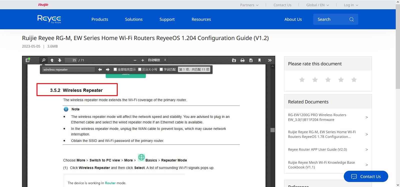

You can try to configure wireless repeater for this router via this guide on page 35: https://reyee.ruijie.com/en-global/resources/preview/Web-based-Configuration-Guide-ReyeeOS-1204/
You need to unplug WAN port of the router to avoid loop when you configure it to wireless repeater mode, and you can connect to its LAN port so that you can still access the router to configure it when you unplug the WAN port.

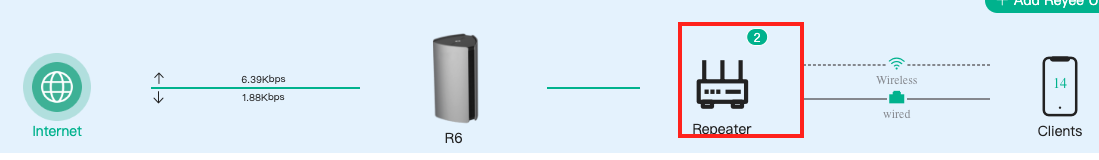

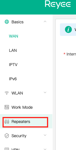

Dear  sir,
If the device is configured as a wireless repeater, you can check the status of the device on the main router.
Home page main router:
Main router > Home page  > More options > Repeaters
0 2024-8-27 08:33:12 View all replies
