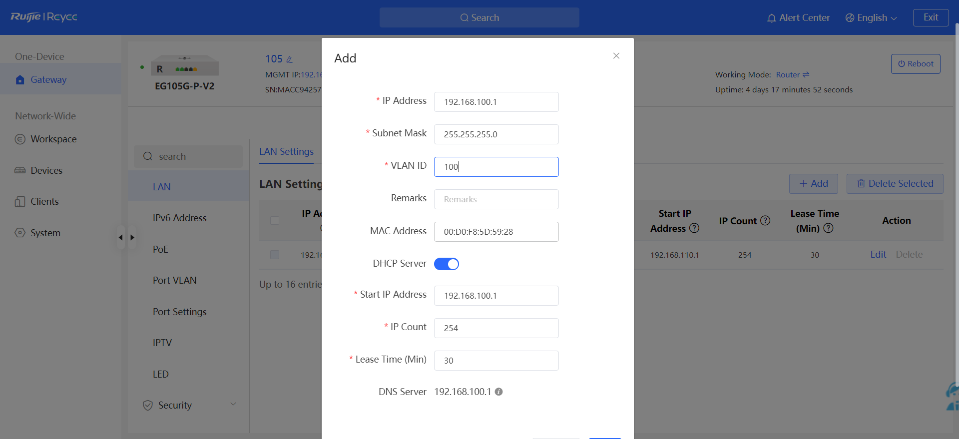

1.Add a VLAN ID and IP segment

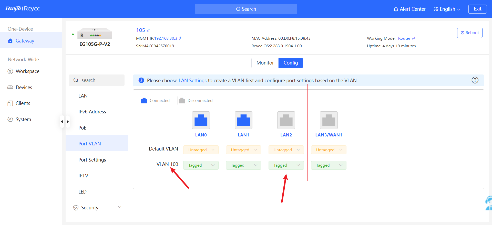

2.Add vlan settings on the port.

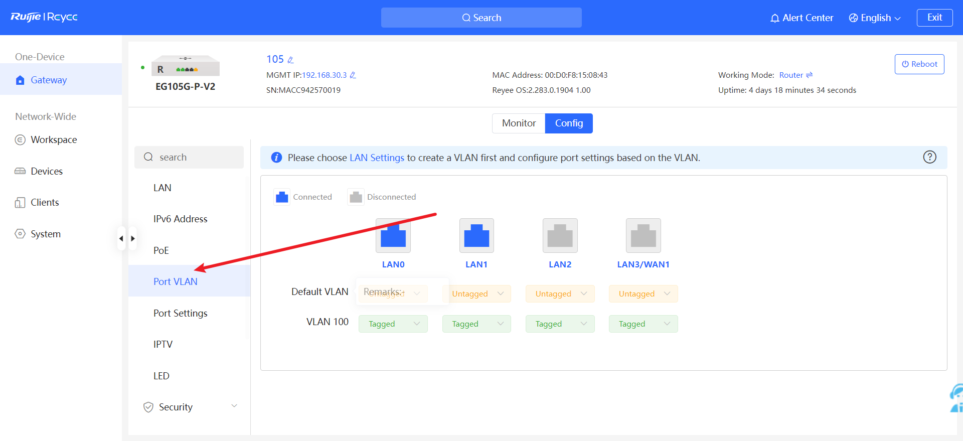

Hello dear

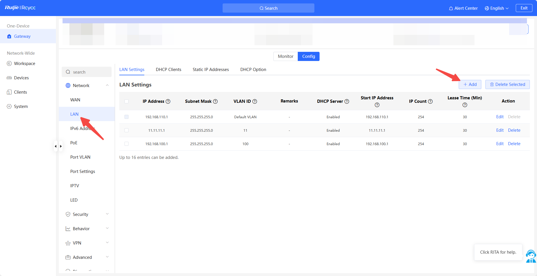

You can add more vlans in LAN setting page just like followed:

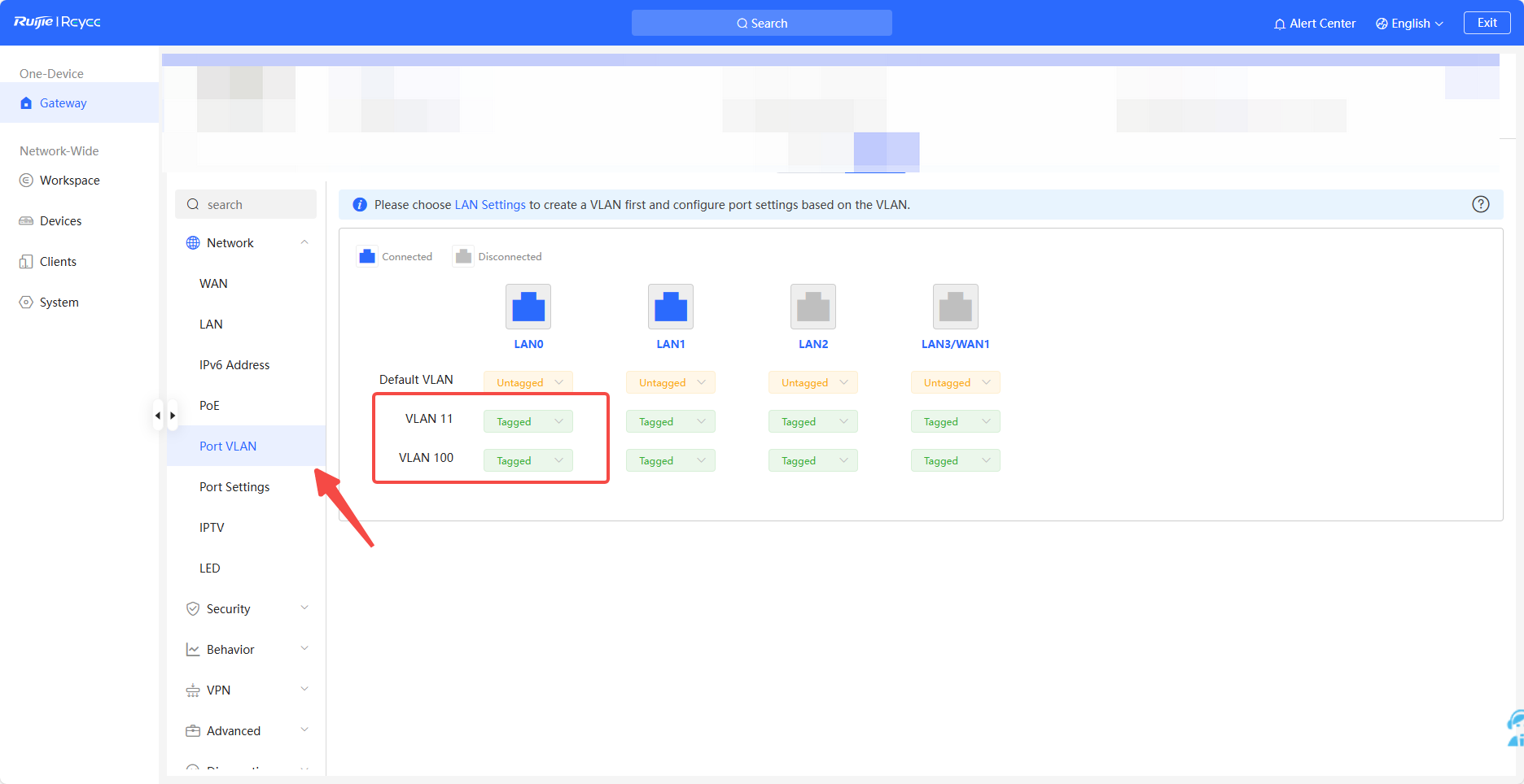

And then turn to the Port VLAN page to tag the LAN0 with more vlans, just like followed:

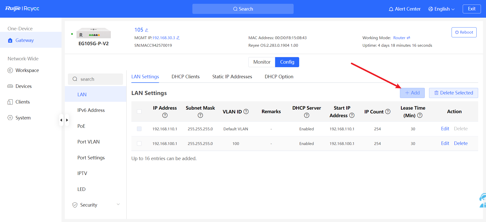

Hello Sean , But it's limited only 16 vlan i need 32 more
0 2024-8-28 14:53:04 View all replies
Eugene Fresco replied at 2024-8-28 14:46

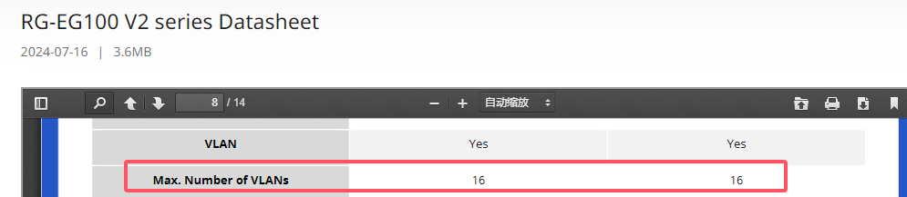

unforunately, this is the limitaion of the device that it can only support up to 16 VLANs
0 2024-8-28 18:07:10 View all replies
GTAC-Ross replied at 2024-8-28 14:53
unforunately, this is the limitaion of the device that it can only support up to 16 VLAN ...
What Device Support More than 16 Vlans Can you give me the link
