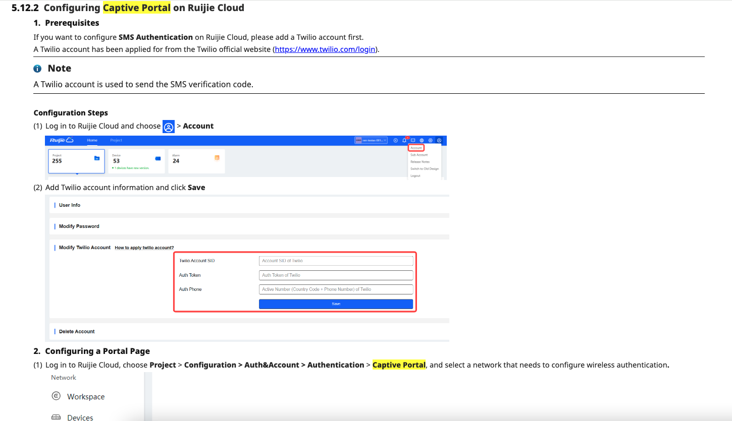

To cofigure Captive Portal on the Ruijie Cloud, you may check this configuration guide:
Click here to view the configuration guide.

Yes, I have been through the pages you mentioned and that works okay but, it only goes through the configuration for creating pages on the Ruijie Cloud Platform, I want to authenticate to an EXTERNAL portal, as I mentioned previously.
The problem I have is that, even though it works okay, the Ruijie Cloud Portal pages are not customisable enough for what I need.

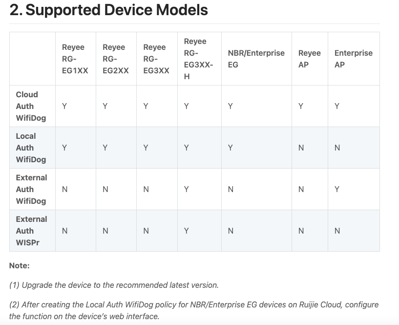

Sorry that RG-RAP6262 does not support with external portal.
Devices supporting external authentication:
Ruijie Enterprise APs: All models and versions
Reyee EG routers: Models running R237 or later, and EG3 series containing the letter H, for example: EG310GH-P-E/EG310GH/EG305GH-P-E.

Sorry that only these device can support external authentication:

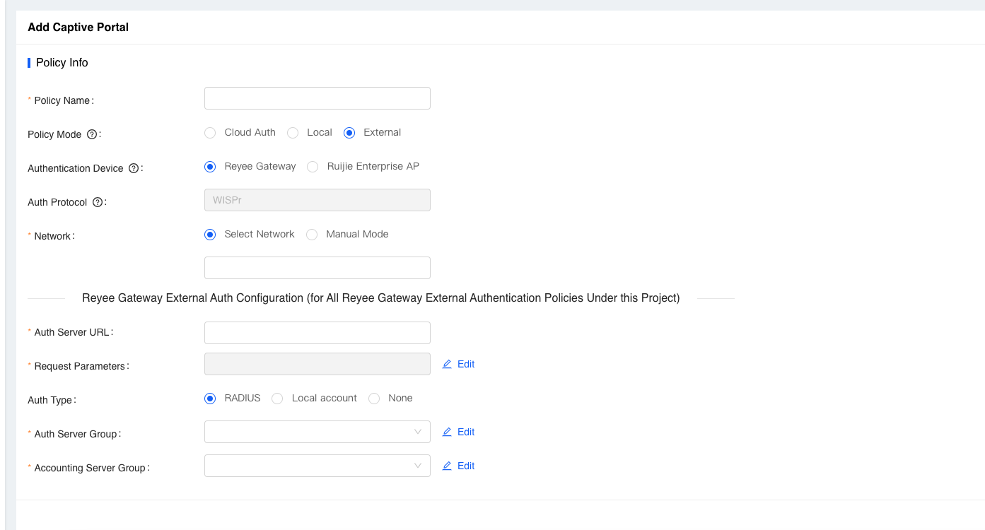

Yes, and before configure this external captive portal, you mighe need to delete all of the internal portal policy first.
Then you can configure this external policy like this:
Here's the exact list of the device that can support External captive Portal
