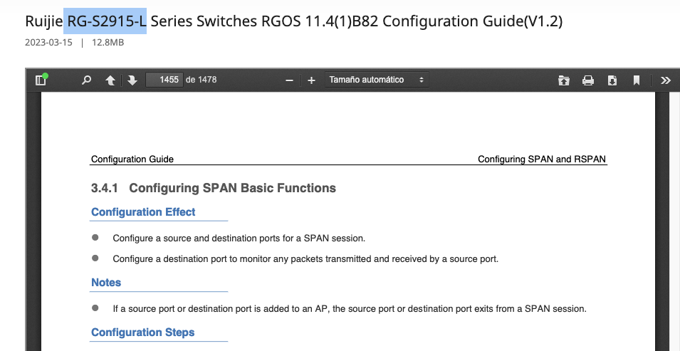

The S2915 device supports the configuration of Port Mirroring, known in the brand as SPAN. Here is the link to the configuration guide, section 3.4.1 discusses the configuration of this feature.
https://www.ruijienetworks.com/resources/preview/77422/
The CS83 series also supports Port Mirroring.

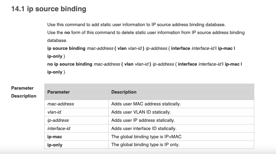

I would like to ask again about the S2915-L. I found that the configuration guide mentions Port Security in relation to other topics, but there is no specific section dedicated to it. Could you confirm if the S2915-L supports Port Security?

Sir,
Good day.
About Port-Security, you may check this out: https://www.ruijienetworks.com/resources/preview/77421/
