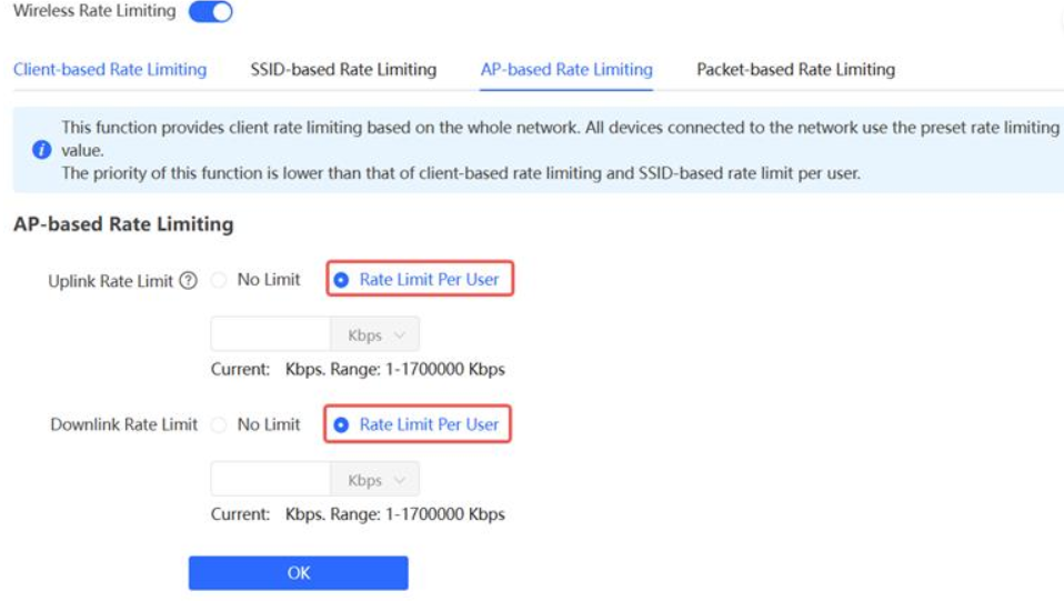

I want to put limit per AP, how can i do this?
0 2024-9-9 17:11:10 View all replies
Kevin Bryan Laurea replied at 2024-9-5 09:32
Hi!
about your need, you can check Configuring
AP-based Rate Limiting.
Choose
Network-Wide
> Workspace > Wireless > Rate Limiting > AP-based Rate Limiting.
(1)
Enable Wireless Rate Limiting.
(2)
Set the uplink and downlink rate limit modes to Rate Limit Per User, configure the rate limit values, and click OK.
If you think this function still can't meet your needs.
You can directly limit the port speed of the switch that the AP connect with.
