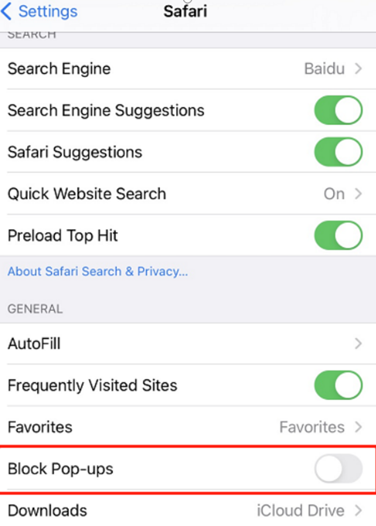

3.3 Portal Page Pop-Up Blocked by the Client
  • Enter any IP address, for example, 4.4.4.4, and check if the authentication page pops up. You are advised to test this function on a PC. Check whether a redirected URL is displayed in the browser.
  • Use another client device for testing. If the issue occurs only on a specific client, it may be due to restrictions on that client.
Solution: Check if the client has pop-up blocking enabled. The following uses an iPhone as an example.

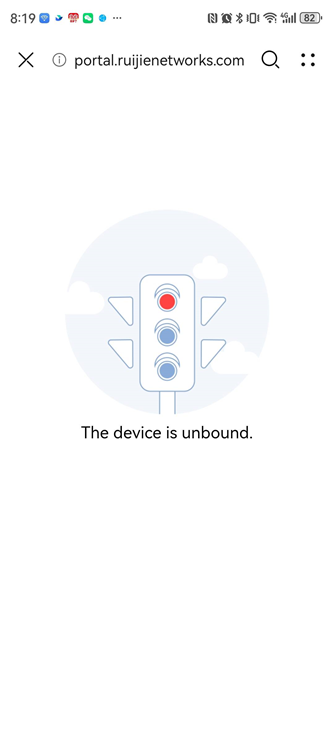

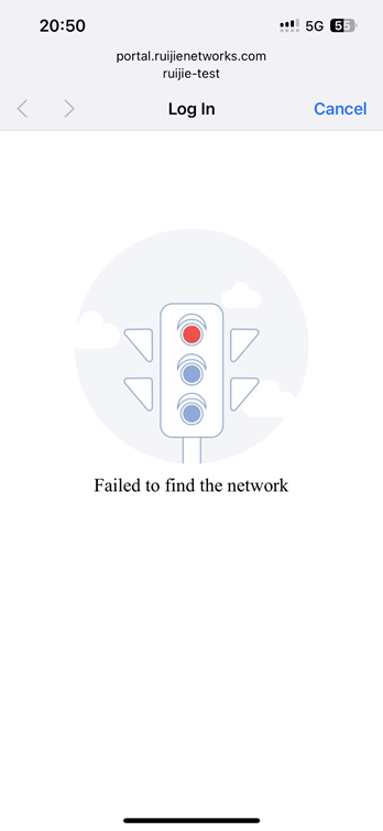

Issue 2: Portal Page Errors
Issue Description
In the Ruijie Cloud authentication scenario, a portal page error occurs.
2. Cause Analysis
(1) Client DNS error. The domain name of the portal server cannot be resolved.
(2) The portal server address on the AP is incorrect.
(3) The authentication configurations are not synchronized to the portal server.
3. Solution
3.1. Client DNS error. The domain name of the portal server cannot be resolved.
Ping the domain name of the portal server. Check if the address parsed by the server is the portal server IP address in the corresponding area.
Two portal servers are available for captive portal authentication on Ruijie Cloud:
Address of the AS Cloud server: portal.ruijienetworks.com  ip:35.190.54.251
Address of the EU Cloud server: portal-eu.ruijienetworks.com  ip:18.199.19.66
The EU server is shared by other regions, such as the US and the Middle East.
Devices connected to the AS Cloud should use the AS portal server, while devices connected to the EU Cloud, US Cloud, or ME Cloud should use the EU server. If a device connects to a cloud that does not match the server, an error may occur.
A parse error may occur due to the following causes:
1. The DNS server is incorrectly configured.
2. The public address becomes the address of another region due to the use of a VPN.
Solution: Specify the correct portal server address on the device.
3.2 Incorrect Portal ServerAddress of the AP
The portal server configuration on the AP is incorrect, or the portal URL delivered by the cloud is incorrect, resulting in an incorrect redirected portal address. For details about troubleshooting steps and solutions, see .3.1.
3.3 Authentication Configurations Not Synchronized to the Portal Server
After portal authentication is configured on Ruijie Cloud, the configuration is automatically synchronized to the portal server. However, there are times when this synchronization fails, which can lead to errors during client authentication.
Solution: Delete all authentication configurations, and reconfigure them for synchronization.
